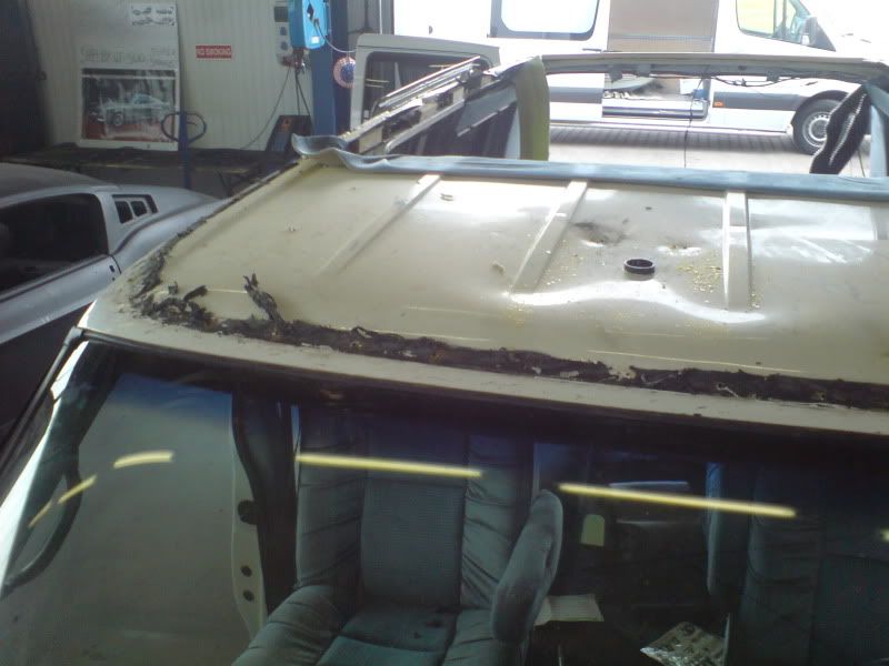

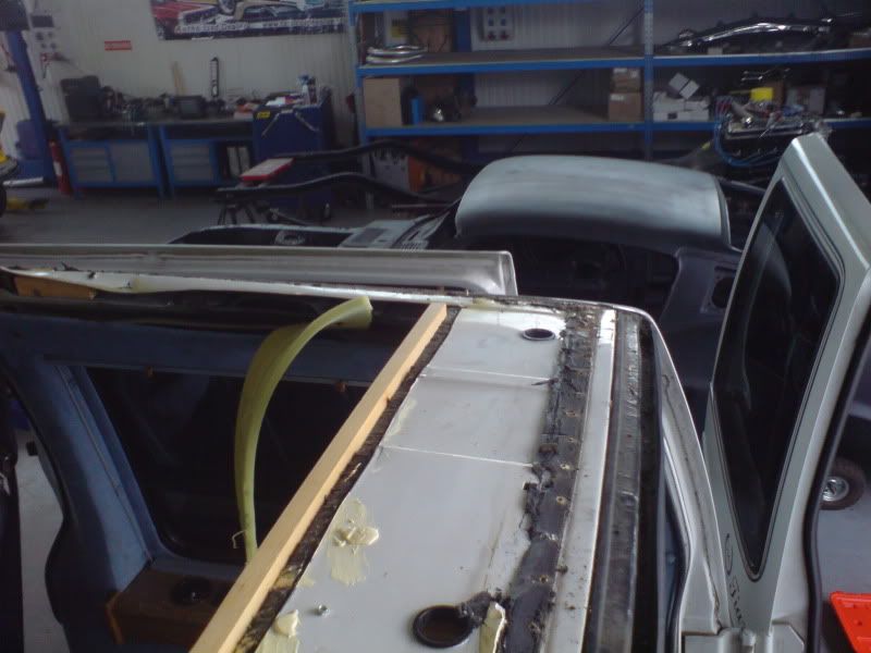

Taffy. don`t cut all the roof away, leave something to hold her strength.
Here some pictures from the JY astro.
This how mine Astro looks
There are some small differences , but that won`t be a problem..
Your Dad is doing a great Job. Buy him some BEER :cheers:

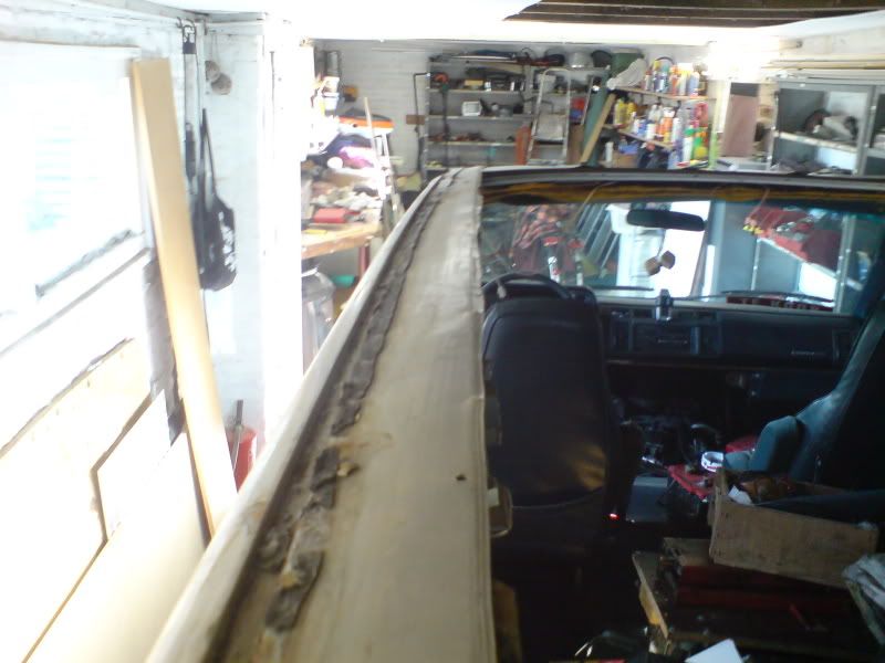

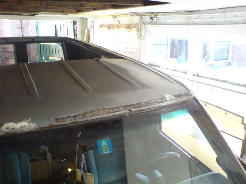

Postby Taffy25 » June 5th 2010, 3:10pm
il get my mate to help me lift my roof off later or tomorow and get you some pics, the company has cut more on the front off the roof, think if i had a crash and i lifted off my chair id cut the top of my head off on the old roof.
Thanks for the support pics, went and double checked, nope they didnt reinforce anything on mine they did leave about the same around the sides though.
Thanks again mate, really appreciate it.
