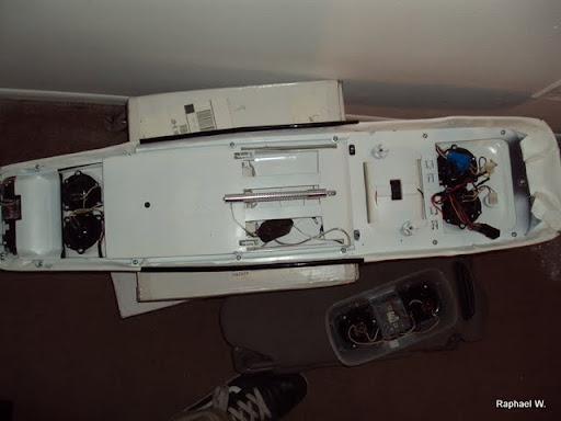

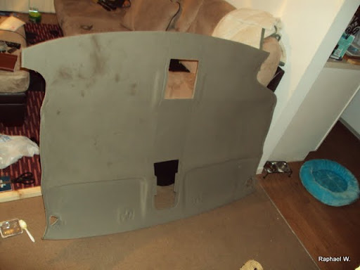

As you can see there was a-lot of dirt above the drivers head(Bought the van like this).

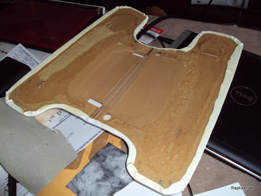

The board in the back was a little cleaner but still had spots on it.

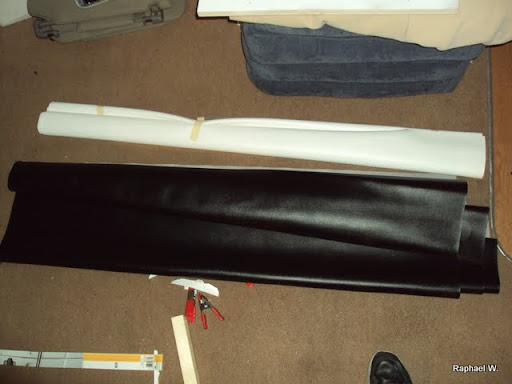

I upholstered the center console with a white vinyl on the top and painted the bottom gold. I also trimmed back some of the top (Will show later) to add a "Mood Light" (The silver bar you see) that gives of a soft blue glow when the switch is turned on. I plan to fix this and have it come on with the car (Easy) by time in install the upholstery back in the car. (Have to wait 3 days for dap to set before exposing to 150F + temps (I live in Florida). I tested it by placing it in the car before the three days and the vinyl shrunk and the glue failed on some parts. (Costing me more money).
I used "Marine Vinyl" for this mission. Available at JoAnnes Farbrics http://marinevinyl.org/ As you can see this vinyl is meant to sit in heat and won't damage under moisture. I wanted to avoid using what ever vinyl GMC placed on the car door as mine cracked under my sharp elbow. (Next Project) I assume that the previous owner never used the arm rest on the door as there where no cracks until I bought it. :poke:

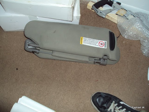

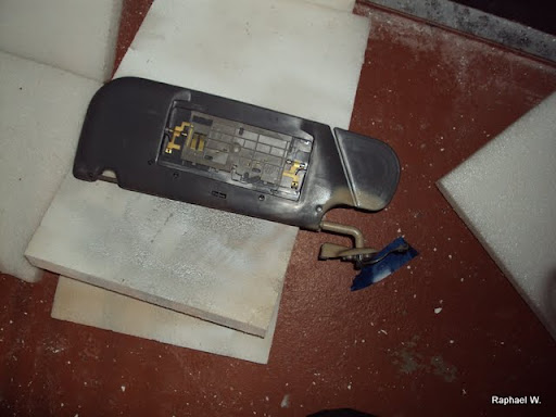

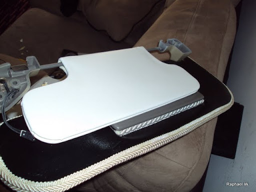

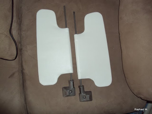

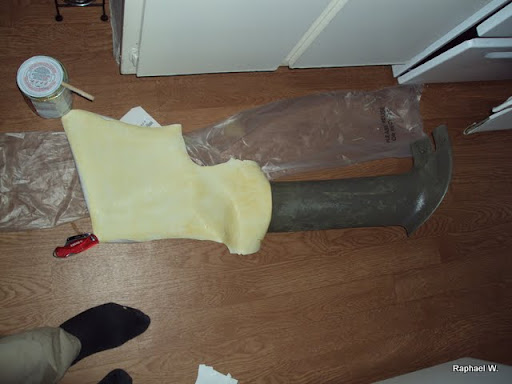

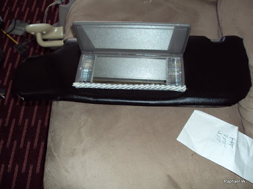

The Sun Visor
They look so disgusting!

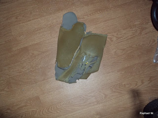

So much better. I'm an Artist! I found it impossible to open the Large visor to do my upholstery so I had to work with a closed unit. Could not hide the edges very well so I decided to cover it with the rope like edging. The small one (White one) I was able to open and did that one without any hassle.
The foam soaked up all the smoke from the previous owner.
Image The plastic Cracked one of the mirrors while placing it back in the casing. :( Thats ok as I want to get a mirror that is flat anyhow without that bubble mirror. I will probably look in a junk yard for one one of these days when I get the money.

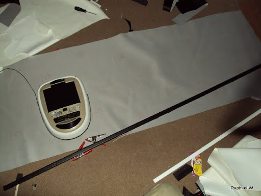

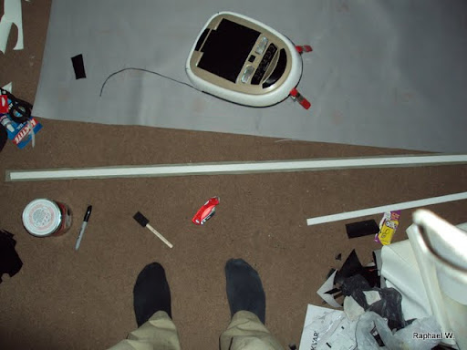

The Mini TV

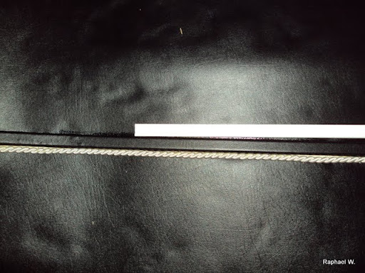

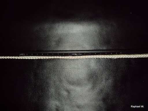

My van came with a TV in the rear that black with a grey vinyl boarder. I wanted to keep the black originally but I broke the back of the TV long ago when I hit it with my head. I repaired it with super glue and it has been fine since but I had to sand the super glue down to make it smooth. After getting it smooth enough I painted it. It came out fine (Not able to tell it was ever cracked. but yesterday I decided to make the screen black on the back (White Front) as hands will touch it a-lot. So I placed Black Vinyl over the back (Where it was cracked / painted over). I placed white vinyl over the boarder of the screen and made the top gold to match my console. In this picture and the one below you can also see the bar (Mentioned below) in the process of me making it. (Above) Completed black vinyl bar. (Below) incomplete vinyl bar with glue setting.
Double sided tape started to wear on my tv so I placed some dap on it. I love this light since it makes it seem like a theater.
Image most of the indentations you see on this piece come from me walking on the headboard (It's large) they dissipate after a while but I need to walk on it to work on it.
As I said Earlier the heat slightly shrunk the vinyl back so I had to create a bar to hide the pulled back part where the two vinyl pieces joined (At the white rope) I did this by buying a long vinyl molding from home depot $2.09 and covering it in the black marine vinyl. In this picture I layed the glue out where the bar is going to be set.

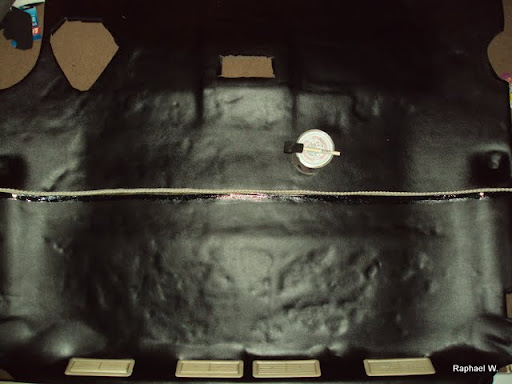

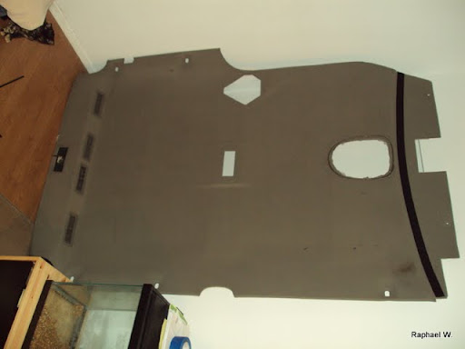

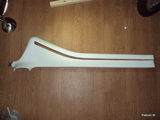

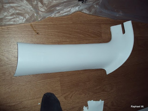

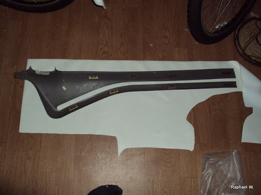

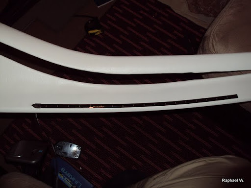

Here are some more updates. (What I did Yesterday)

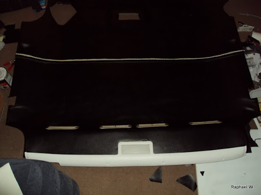

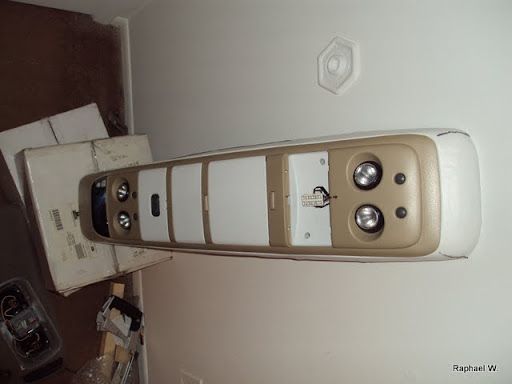

Image Letting glue set on Panel. I used to have lights on these panels but I thought it would be better if I relocated them as I do not wish for people outside my car to pay much attention to them. Especially the police.
After Glue set I laid the vinyl over the piece.
This Piece was no fun. After I sanded it I cleaned it with soap and water, then spread Dap all over the piece and the vinyl. The vinyl decided to roll up on me while the glue set, and created a big mess.
It's kinda like working with two pieces at one time.
Light Relocation

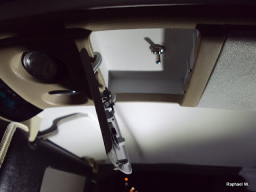

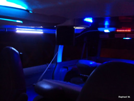

I decided to move the red light to the back of the car and face it down to the occupants (not Illegal) and the white to the door facing inward (Also not illegal).
White facing from door.
Red light installed on back Headliner facing down.
Now I'm going to check all the pieces for imperfections and fix them and probably assemble them back in the van.
Will take more pictures. I will also show the mood lights I added. It makes the car feel like a airplane already.

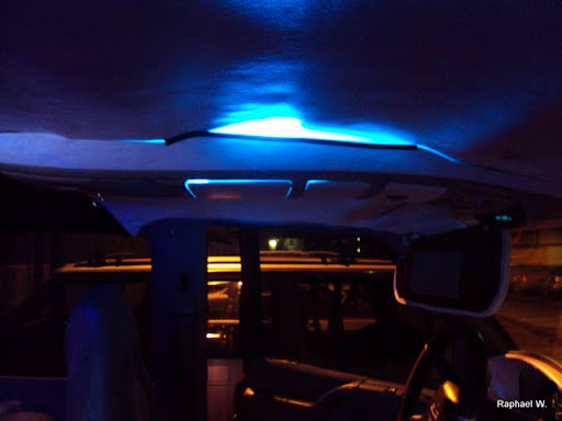

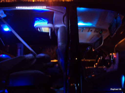

Postby rj_whitten [OP] » September 21st 2010, 9:05am

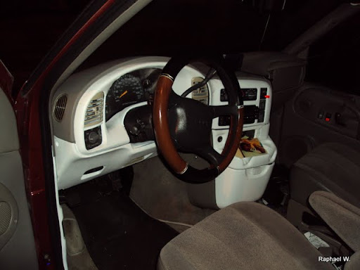

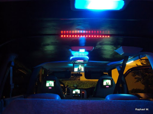

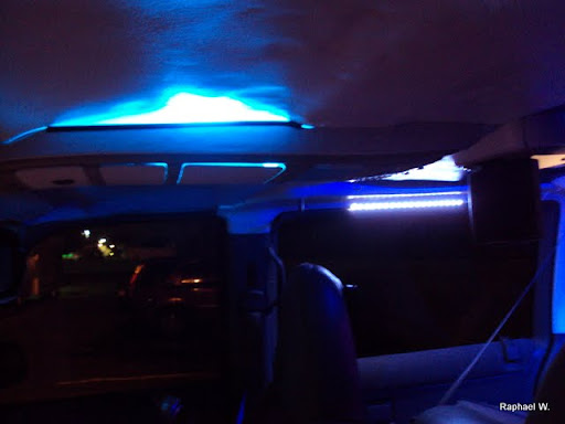

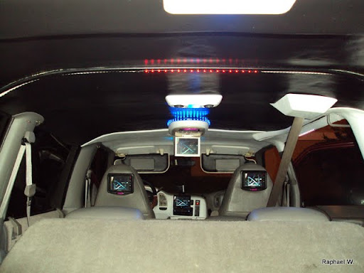

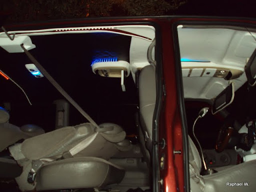

More Pictures! I placed all the pieces I completed in the van. It was a-lot of work and I still plan to do more but I need to take a brake while I gather my thoughts and the materials I need.
These images where all taken at night.
I trimmed off the top of the original center console to expose a gap on both sides. I placed a Blue neon light on top of the console.
You can see the back door light now :), It activates on doors opening and Below is a switch I installed that turns it on manually.
The same neon installed on top of the console is also installed under the kick plates. They all come on when the key is turned to on, AC, and engine started.

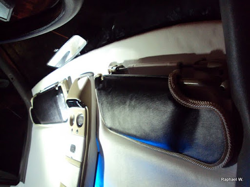

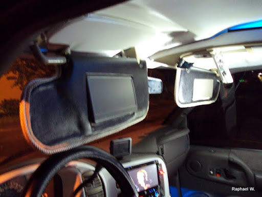

My new sunvisors. This vinyl gives my van a whole new vibe. :mrgreen:
I didn't intend to have a picture of my son there but I keep it there while driving so forgot to move it before taking picture :)
Now I must do something about the seats, side panels, and the rest of that filthy carpet. :snooty:
I Love the results. :rolling:
