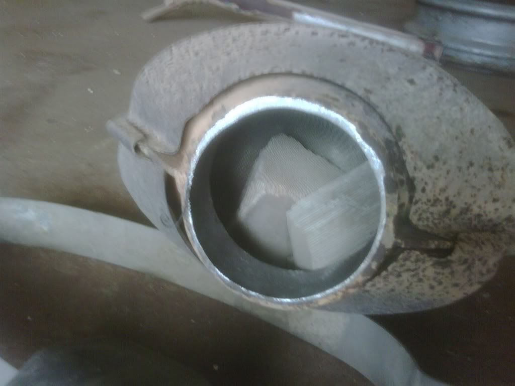

Postby AstroCan [OP] » October 22nd 2011, 6:47am
Finally found out what's rattling and where the performance loss came from. :dance: Got it replaced with a straight pipe.

So what are those blocks in the cat? Are THEY the catalyst material? Or are they some kind of deposits?

That's part of the honeycomb that have broken away.

Correct. And every time I hit the pedal they would be pushed back and plugged up the exhaust. Van is so much quicker now I love it. If you hear a rattle from your cat get it pulled.

if you don't, you can pick them out of your muffler...lol
