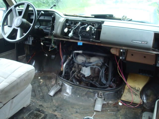

I took some pics today of the inside and outside of what i have done so far. Its raining out so i cant do the bedliner today but i can paint the interior pieces that i am keeping. so here you go.
Thats what i have for now.. not bad for $800 and now that i did a tune up on it it runs like a raped ape. I also have the front interior out now too with carpet and passenger seat out and the driver one unbolted.

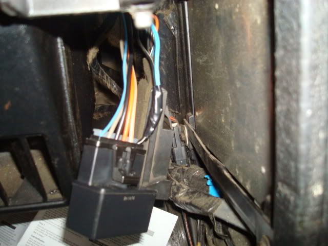

This is where i tied into the power door lock signal wire. its on the passenger side next to the computer.

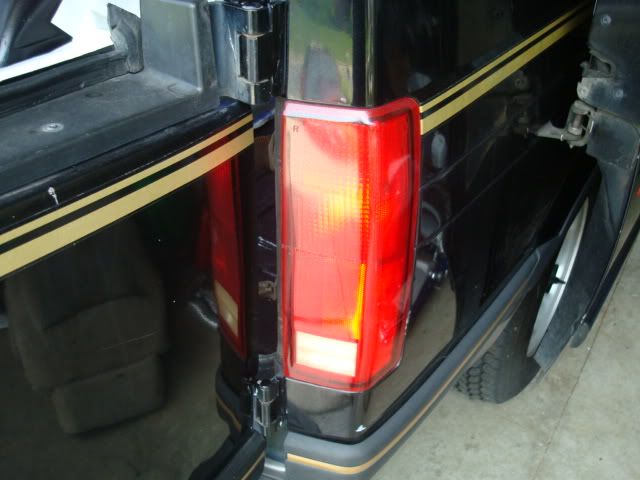

i will start with the tailights. Its a pretty straight forward install. There are 2 screws holding the tail lights in then you pull the side with the screws toward you and then out. quite easy.
Before
Back of the new light

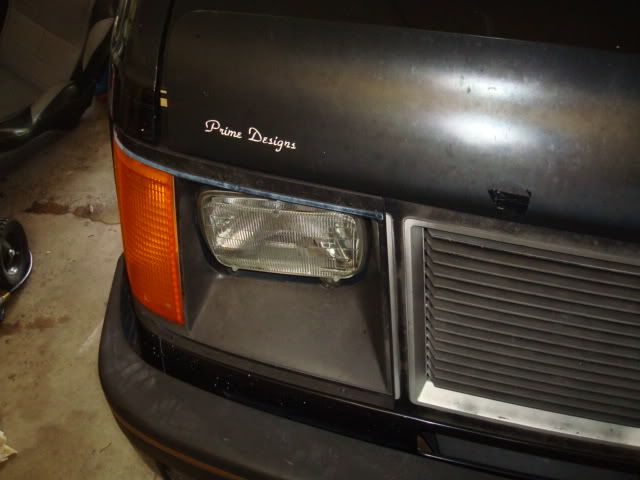

Now for the headlights and clear corners. This was done at the same time since you have to take the corners out with the headlight surround to get to the headlight. I also had to tap the holes in the new corner i bought the cheap ones and for some reason the holes were slightly bigger than the bolts for the original corners. So i tapped them out to 5/8" coarse thread and bought some bolts. cost me about a dollar. the new headlights are projector lights with H4 bulbs and they also have a blue bulb that turns on when you have the parking lights on. You can opt to not hook these up but i did just for show. i just spliced them into the actual parking lamps. I think later i will hook them up to a switch so i can only have them on when i want. So enough chatter on to the pictures.
Before BOOORING
The headlight cover is held in by torx screws. Its a T10.
Back of the headlight cover there are 10mm bolts that hold the corner light in.
