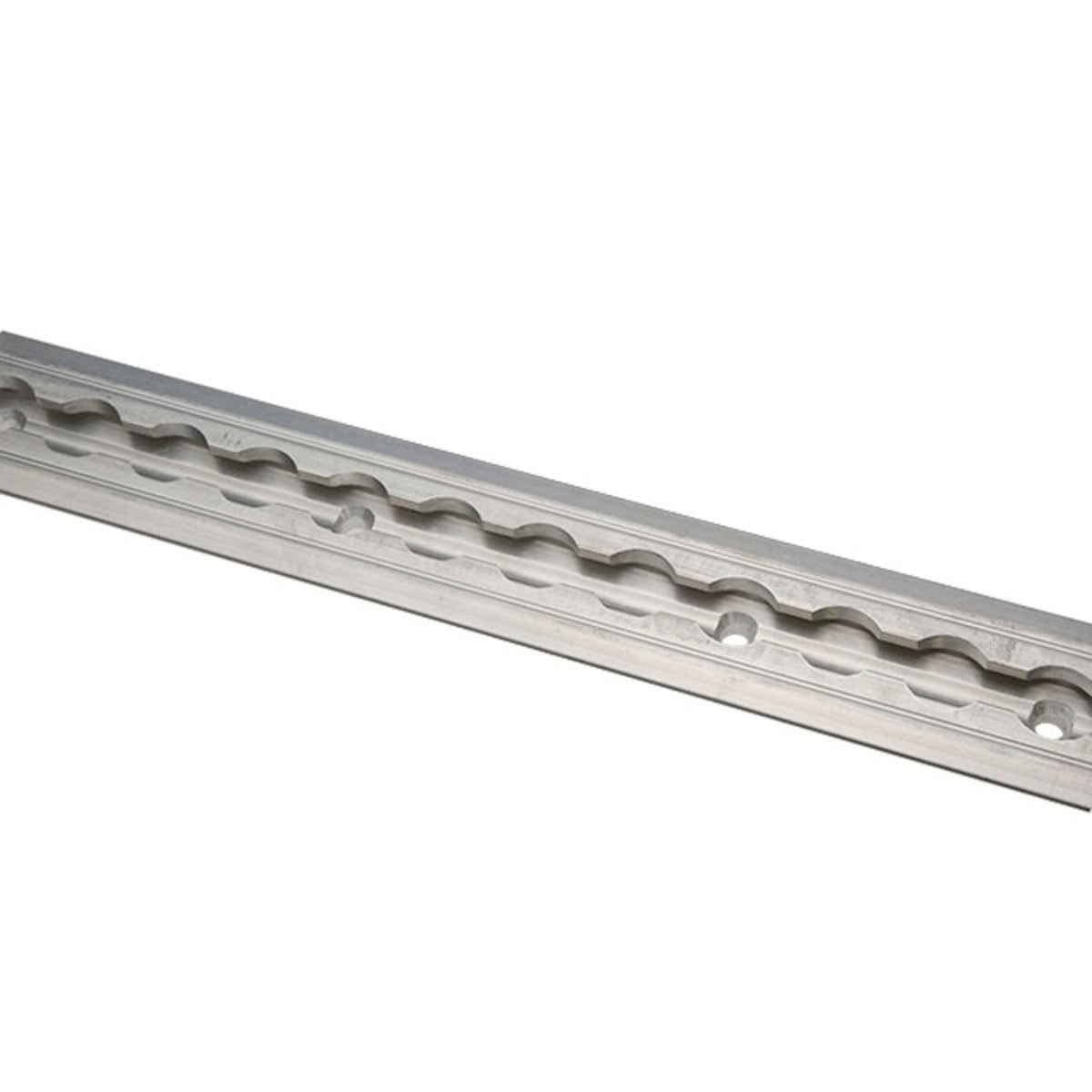

Rubber floors are coming along! Hardwood that I had in there rotted!
I used these tiles:
https://www.amazon.com/gp/product/B08D5ZM6KW/ref=ppx_yo_dt_b_asin_title_o00_s00?ie=UTF8&psc=1
This rubber:
https://www.amazon.com/gp/product/B071X7TYYM/ref=ppx_yo_dt_b_search_asin_title?ie=UTF8&psc=1
These L track channels:
This hatch for the hole to swap the pump:
Learning lessons:
1. Rubber sealant takes a while to harden when layed down 1/4" thick (a full week in some places). I had to use 10 gallons to level the whole floor because It lost so much volume after drying. Next time I would use silicone or some other rubber. Also it gets hard but stays slightly tacky, this is fine since I have a layer of tile on top. Lastly, it is hard to get it super flat but it does smooth out over time with the pressure of the tiles on top.
2. You need 72sqft of rubber tile not 48. You loose a lot in scrap when trimming!
