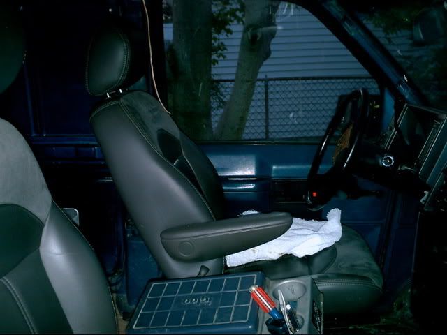

the very first thing I did was change the front uncomfortable beat up seats with a set of 2001 Pt cruiser leather, heated driverside full power seat...with very little modification and relocating two bolt hole wala they are in:
