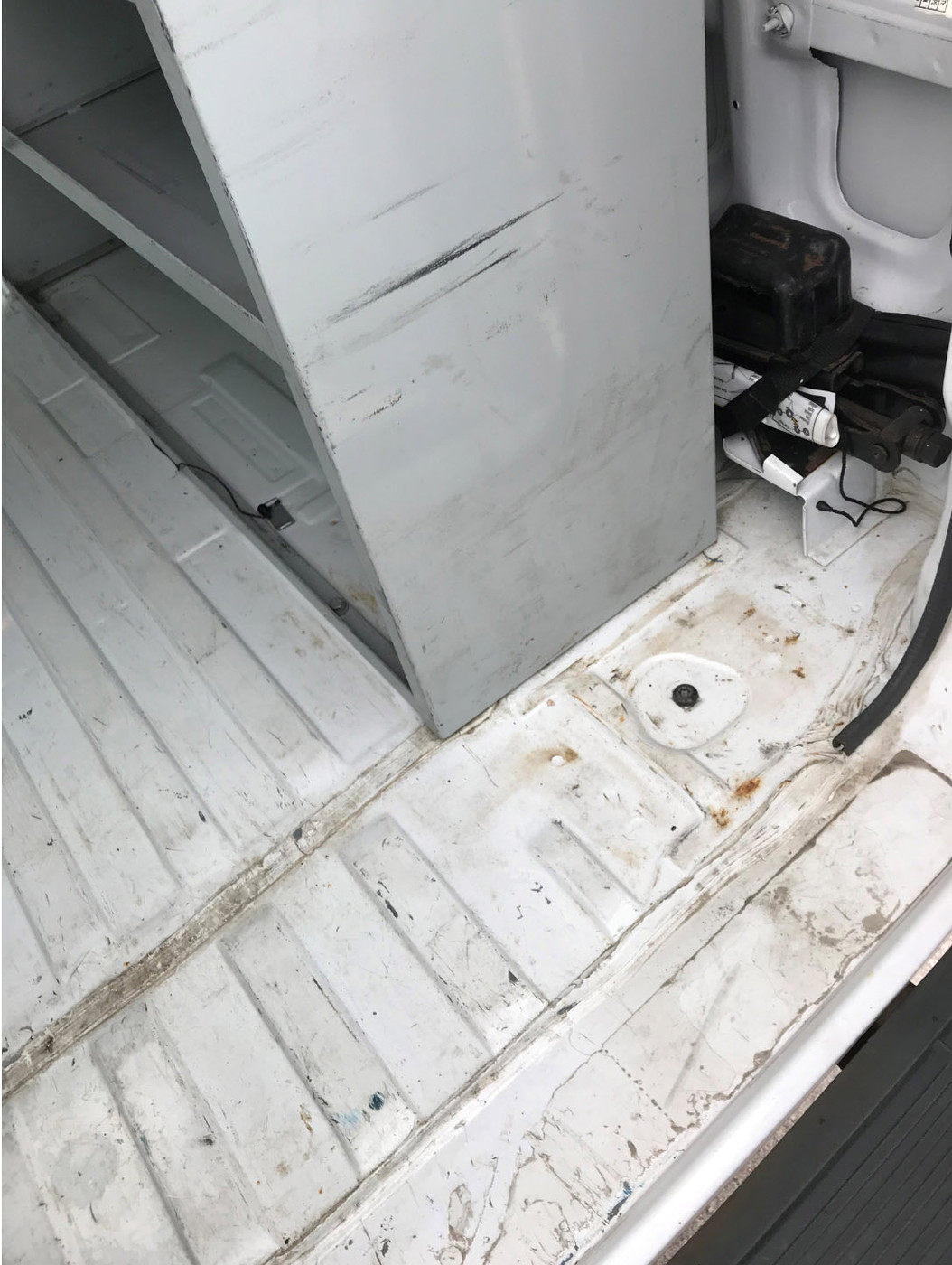

Just minutes ago, a second friend of mine had a look at it too and sent me these pictures, which I think are more alarming. I'm also told by the dealer that the hood was replaced because of rust. Gah. As this was going to be my daily driver and pride & joy, I think that the rust is a deal-breaker, but would still like to hear opinions of others.
I mean, look at that driveshaft!

Re: RUST. Buy or walk away?
Postby Rockridge » May 27th 2020, 2:07am
RUN AWAY FROM THAT! Doors look like they are ready to disintegrate. All that bubbling is rust ready to blossom.

Postby sfeaver » May 27th 2020, 2:09am
That's starting to rust pretty bad.. That pic of the underside of the drivers footwell looks like its close to going right through. Plus the bubbling on the doors in the other pictures. Its hard to stop it once its that bad, even if you cut out parts and weld in new.
Postby Rod's Trucks » May 27th 2020, 3:47am
OH, my!
it is great that you got a second pair of eyes to look it over.
Those photos look like a different vehicle than the previous ones.
Rust bubbles like that are just the tip of the iceberg. There is likely some serious rust under that paint.
I retract my previous statements, but with the low miles, it would probably make a good donor vehicle for the mechanical parts.

Postby MechBob » May 27th 2020, 4:18am
Different areas,different climate.My 94 is really rust crappy, underneath, but the body panels are very good.Would be better If I had run it through the car wash regularly.That van looks like a 300-500 dollar van,to me

Postby 90safari » May 27th 2020, 9:19pm
Rod's Trucks wrote:OH, my!
Rod J
Yup, as someone who lives in the salt belt, I'd pass on that one. Not walk away, but rather run. That's the whole key on these vans, finding one that is rust free. Miles don't mean anything to me, cancer does. And engine or trans can be replaced (bolt in). Rockers require cutting and welding, then primer and paint ($$$). On that van you'd also need to find some clean door shells as well (more money).

Postby The Drummer » May 27th 2020, 9:42pm
I betcha my *** ,wich isen t worth much ,that the front rad suports are caved in , they all do that sooner or later , rather sooner when its from salt lands , the frame isent that bad from the pics , i mean i v seen worst , look at my build tread , if its a few 100 s it could be a till you find a good one deal thing and then a parts van , but for long term you will likely end up spending more on it than its worth if totaled , thats just me but i would call it plan B and keep looking ,and wich ever van you look at the first spot to look at is the rad support where the sub frame bolts too ,if that checks out good chances are the rest is ok .

Postby SportsBoy » May 28th 2020, 12:43am
I'd pass - my van had rust when I bought it, but shockingly little for a 20 year old new england car.
If you want this to be your pride and joy for a while, I'd suggest buying one down in the southwest and bringing it home, then doing an underbody rust treatment yearly and get undercarriage car washes after snow storms. Then it will be clean when you buy it and stay clean for a while.

Postby markmitch » May 28th 2020, 3:11am
I'm from Maine originally and used to do state inspections-pass on it unless you can get it cheap then pull the drivetrain to put in a high mileage southern van.

Postby Rod's Trucks » May 28th 2020, 5:30am
Something I just noticed in the last one, of the first set pf pic's...
I cannot quite get myself oriented, but there is a cross member shown, and maybe the oil pan or transmission, and what looks like either a long square tube or angle iron? ? not sure what I am seeing there, but what just caught my eye is a flat plate with two slots in it, and two studs sticking down with no nuts on them... What am I looking at, please?
Postby Leeann_93 » May 29th 2020, 3:59am
Run away.
That’s gone too far to be fixed easily or cheaply. Low miles but hard miles and no care was taken of it - and if we can see that lack of care, what can’t we see?

Postby Mr_Roboto » May 29th 2020, 7:14am
The place to check is the front inner rockers. Stab em with a screwdriver or knife and see if they go through. I think it's where the widshield drains and probably one of the rougher overall locations if I had to guess.
That said, the rockers on that look pretty toasty. Would expect to do full inners at best.

Postby SheldonYoung » May 29th 2020, 11:07pm
Leading Edge Rust, (hood, door edges, etc.) is impossible to eradicate without spending a lot of money.
Any quality Shop will replace before repair.
With that said, anything but doors are pretty cheap in the Reproduction Arena.
