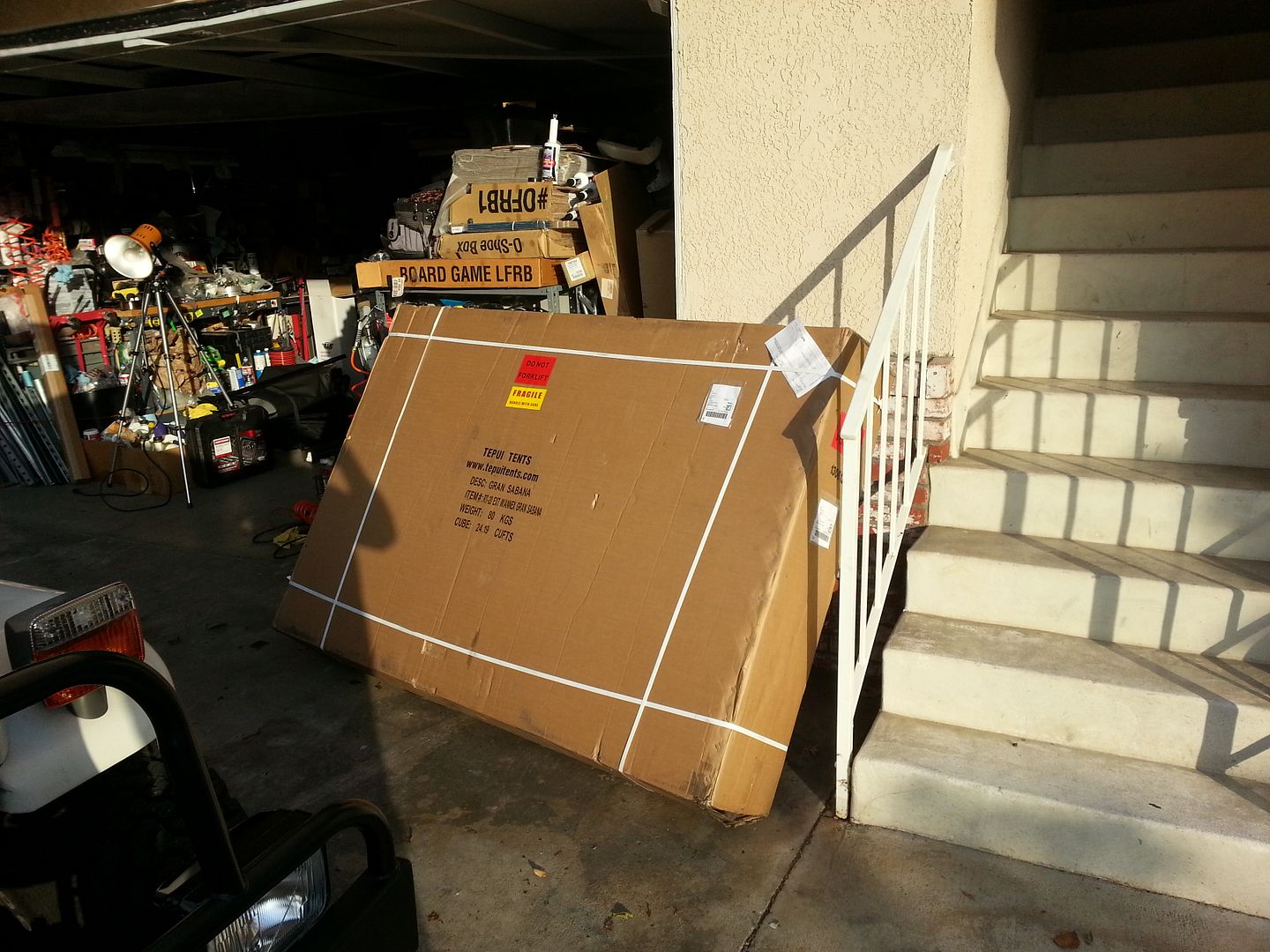

Arrival:

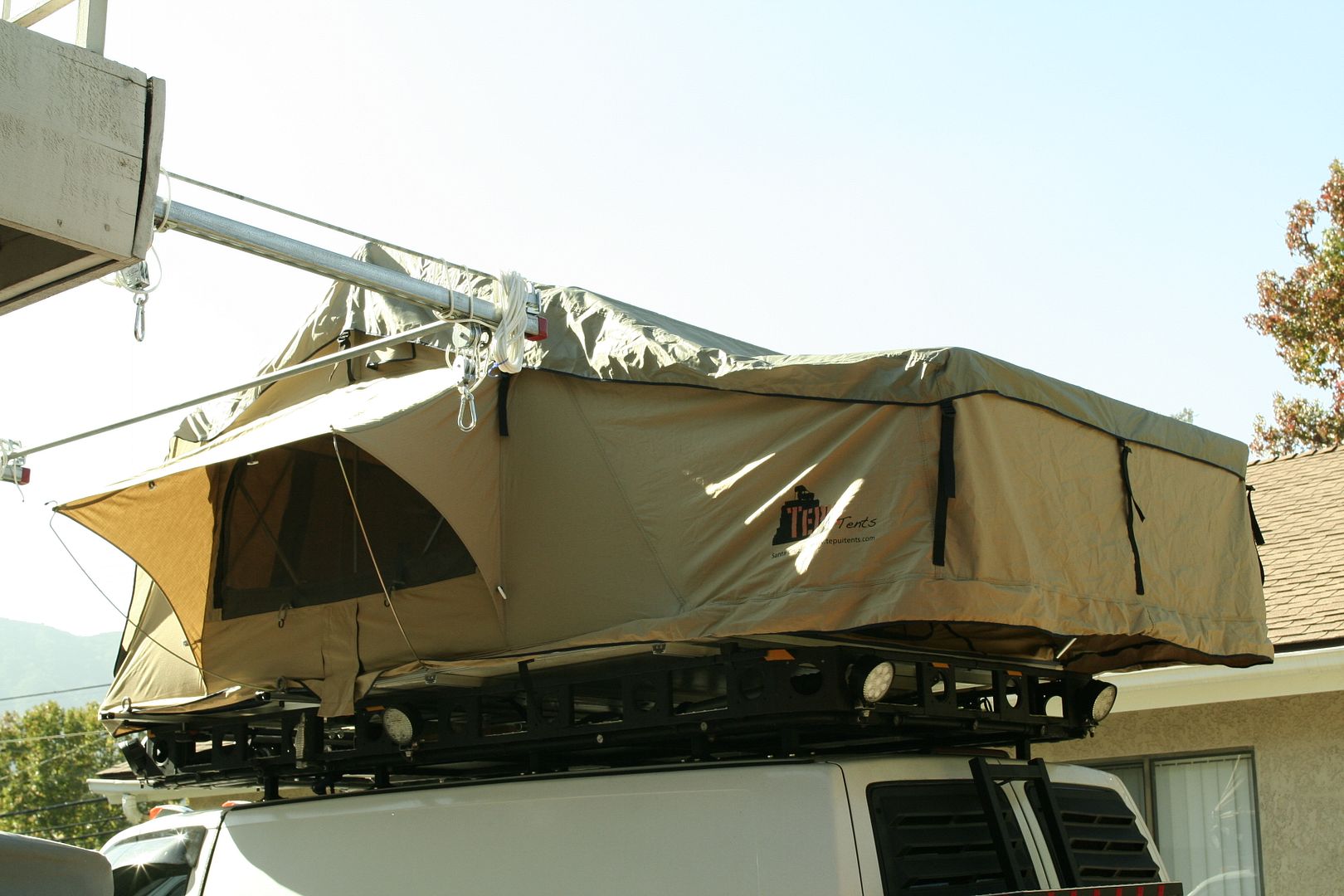

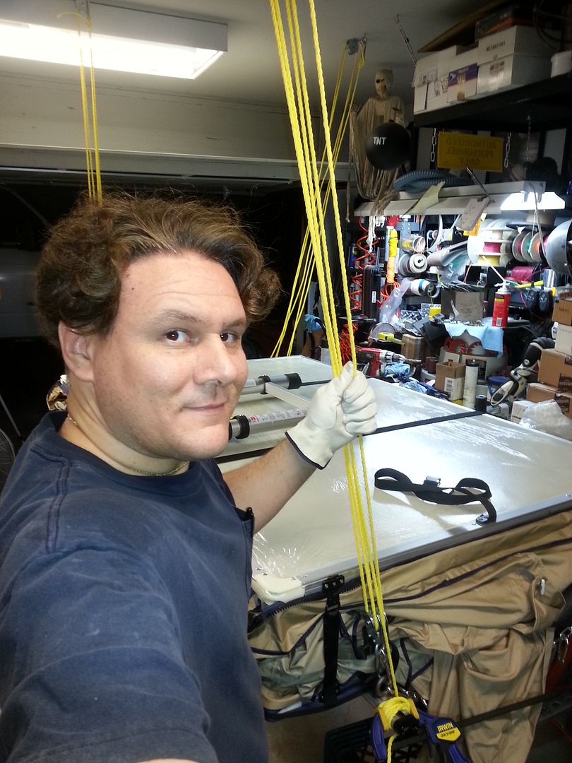

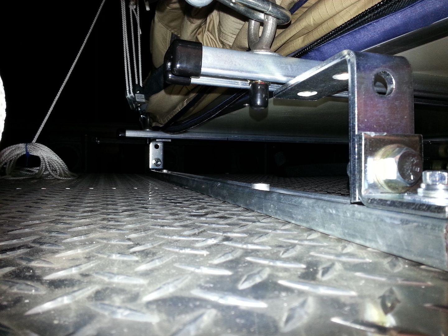

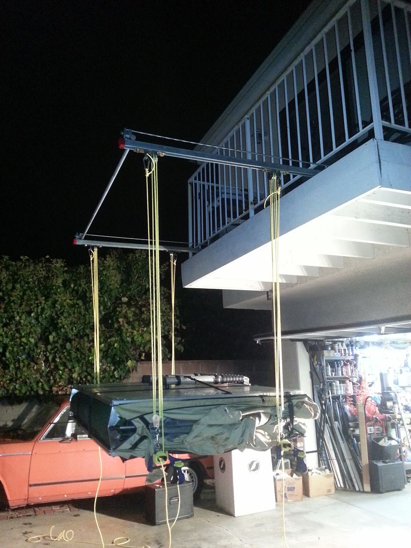

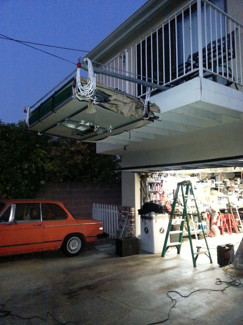

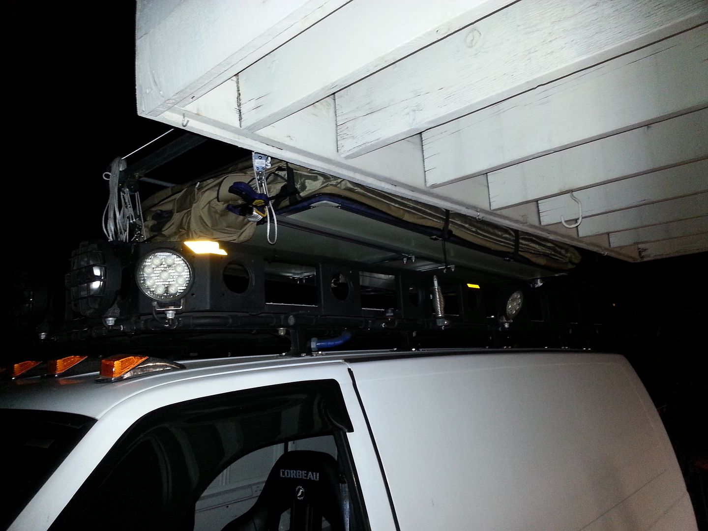

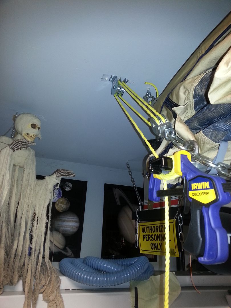

My first order of business was to devise a way to lift the tent by myself up to the garage ceiling. The tent came with aluminum rails that bolt to the floor but I wanted something that would extend beyond the sides so I could attach eye-bolts and pulleys. I'm a huge fan of electrical strut. It's perhaps a bit heavier than the aluminum channeling provided but it would serve to strengthen the floor and allow me a multitude of attachment options for whatever, including attachment to my rack which is also strut based. Here is the basic idea for attaching to my rack upper rails:
I implemented a double pulley system on each corner of the tent. It's not the most convenient design for a one person lift operation but it allows me to get the tent flush to the ceiling with minimal effort. The double pulley system reduces pulling force to 1/4 the weight of the load. With one system per corner on the tent I only have to lift 1/16th of the tent weight, or roughly 12.5lbs of pull force. That's rather effortless.
Up and out of the way. With the storage solution worked out it was time to move on to the rack mounting.
This tent typically mounts to a vehicle rack and opens off the side. The rectangular design facilitates this but I wanted the tent to open to the back of my van. This requires having the tent with the long end hanging off the sides of the roof. For travel that is not a great idea. While not wider than my track width it does hang 8" off both sides of the rack. So my idea was to drive to my destination with the tents long side tucked in and seated below the rack basket rails for safety. Then I can lift the tent and rotate it 90deg once I arrive and attach it to the top rails of the basket. Sounds like a major PITA. I needed a way to easily lift the tent and rotate it so I bought a motorcycle scissor lift jack, stripped off the unnecessary weight and replaced it with aluminum. Then bolted a 500lb lazy Susan type bearing to the bottom:

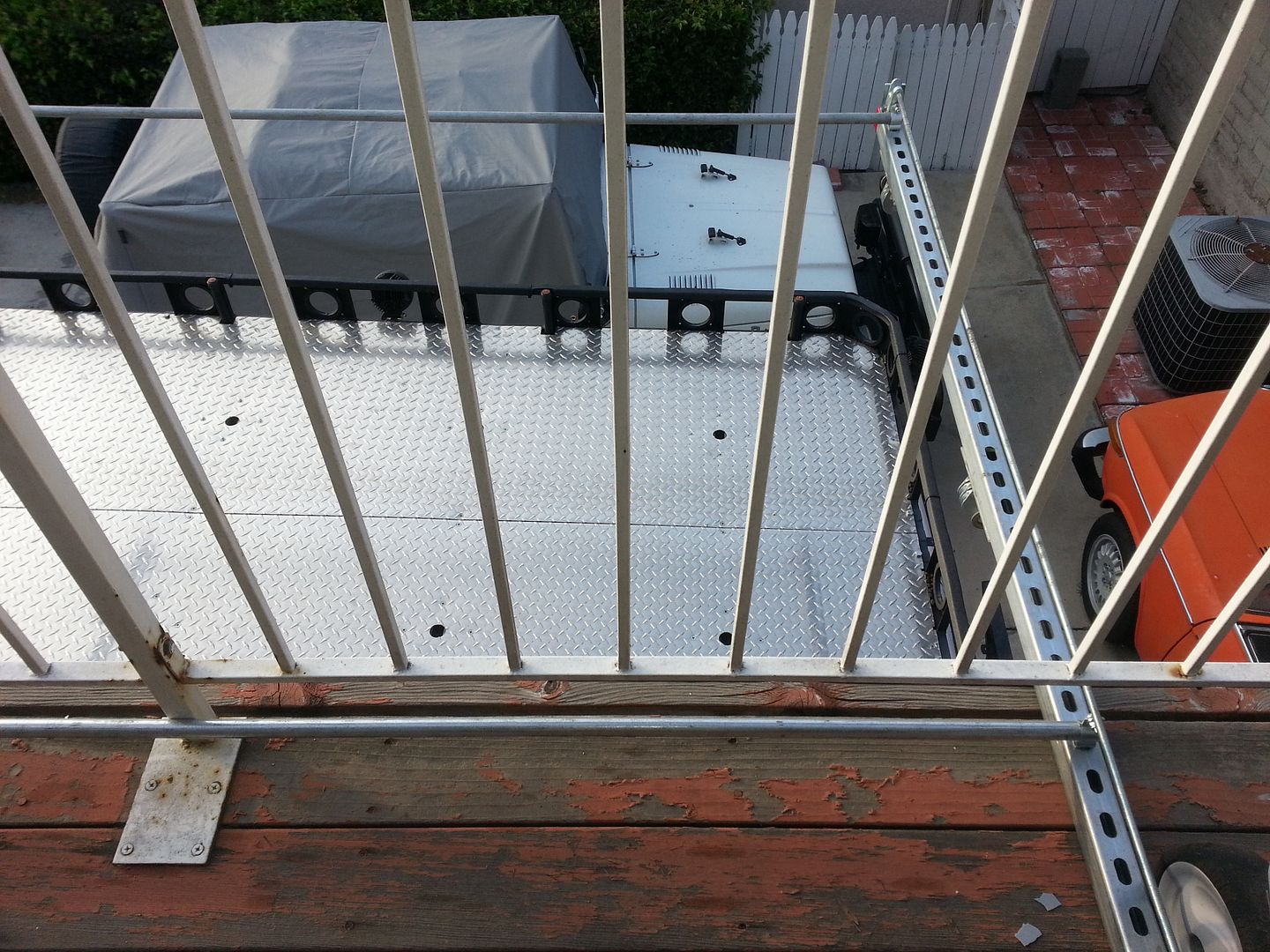

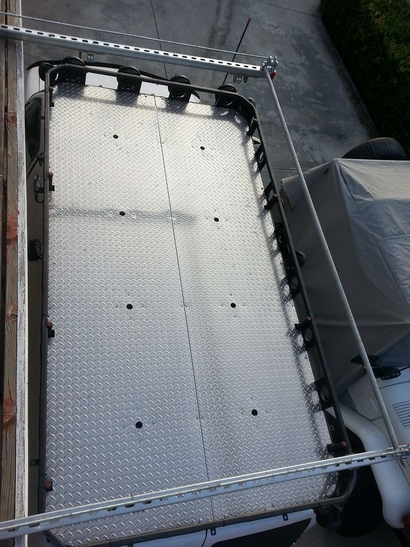

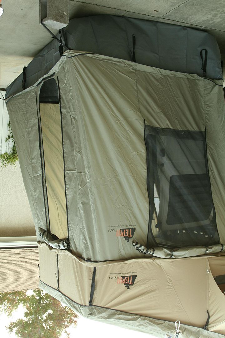

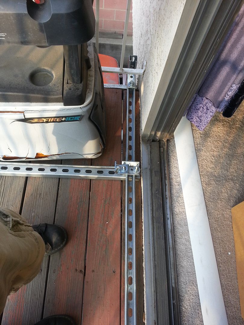

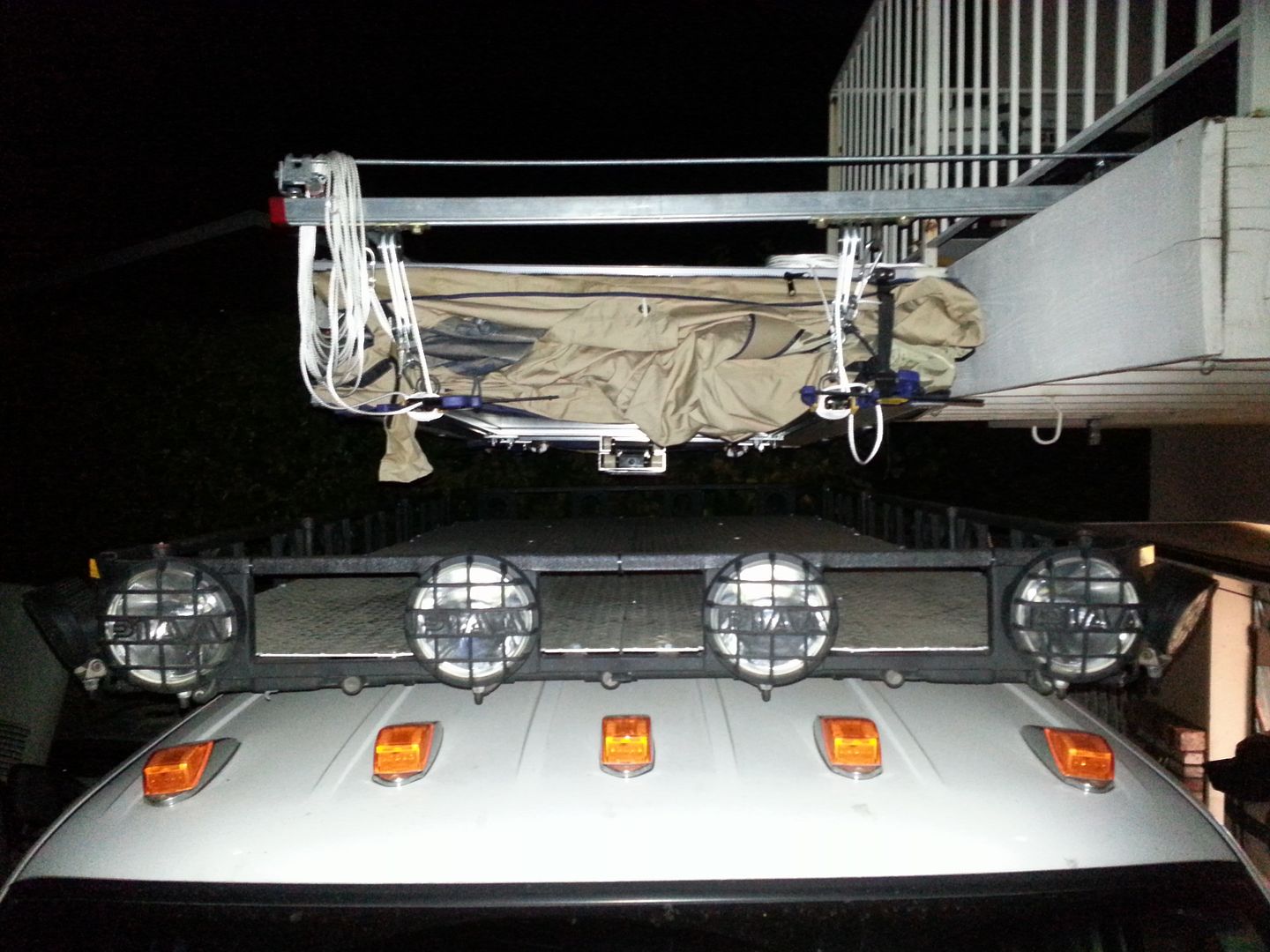

At first I thought I could construct a similar lift apparatus below my balcony to lift the tent and then drive under to get it on my vans roof. Turns out the van is way too tall for that. My next best idea was to construct a lift that was balcony floor height. I wanted the lift to be lightweight, easy to assemble and require no modifications to the building structure. I'm a renter and my balcony is totally rotted and infested with termites! So drilling into it is just not an option. I came up with a design that works, albeit ugly:
The structure rests on the balcony floor and wraps around underneath with no physical attachment and can be assembled in just a few minutes.

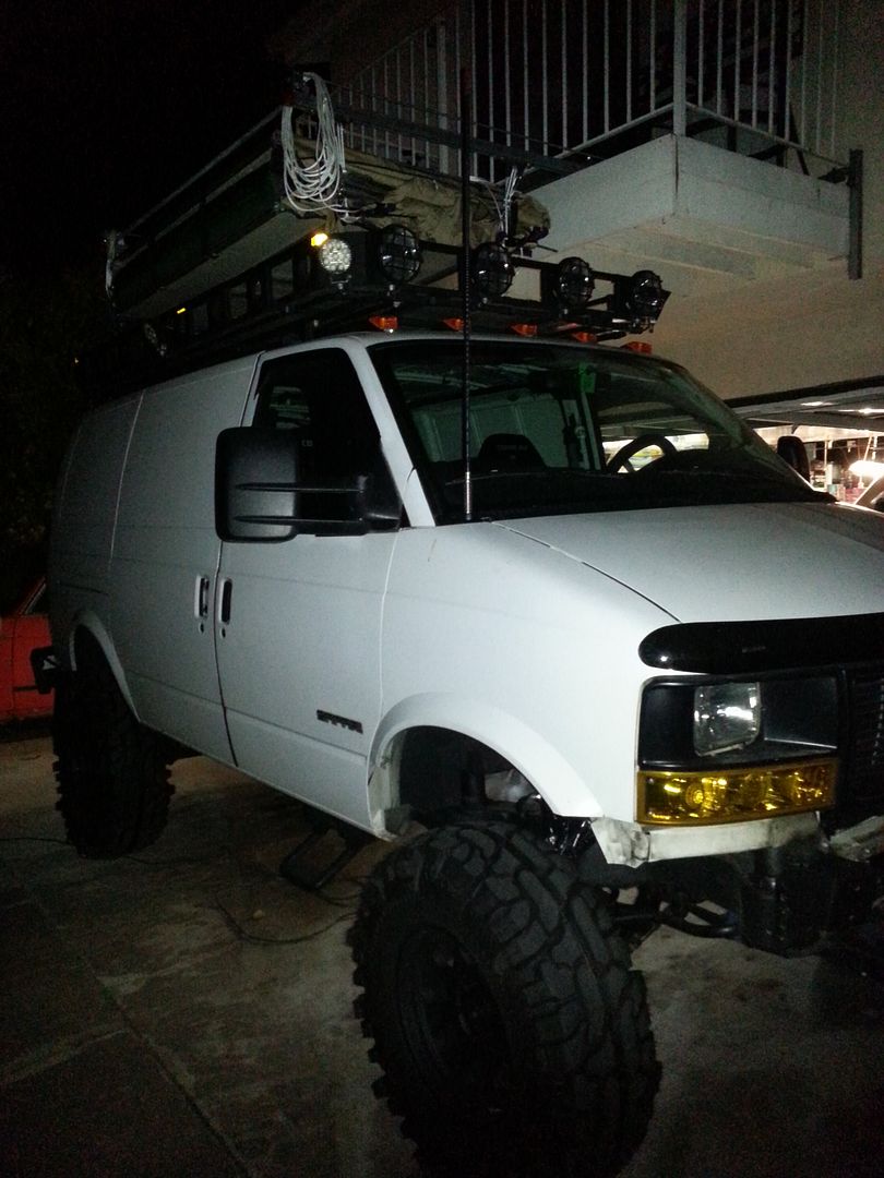

Now I can drive under it:

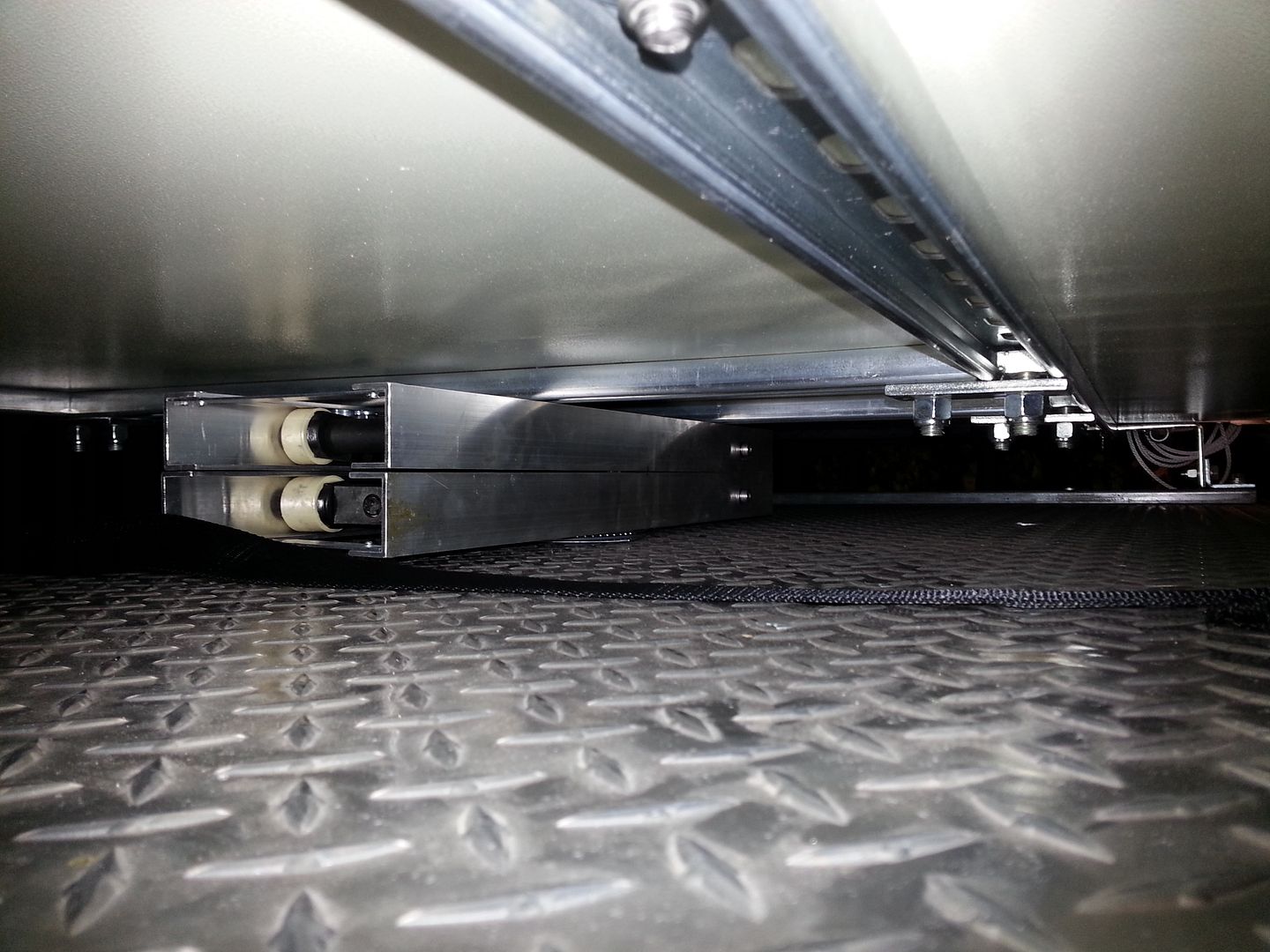

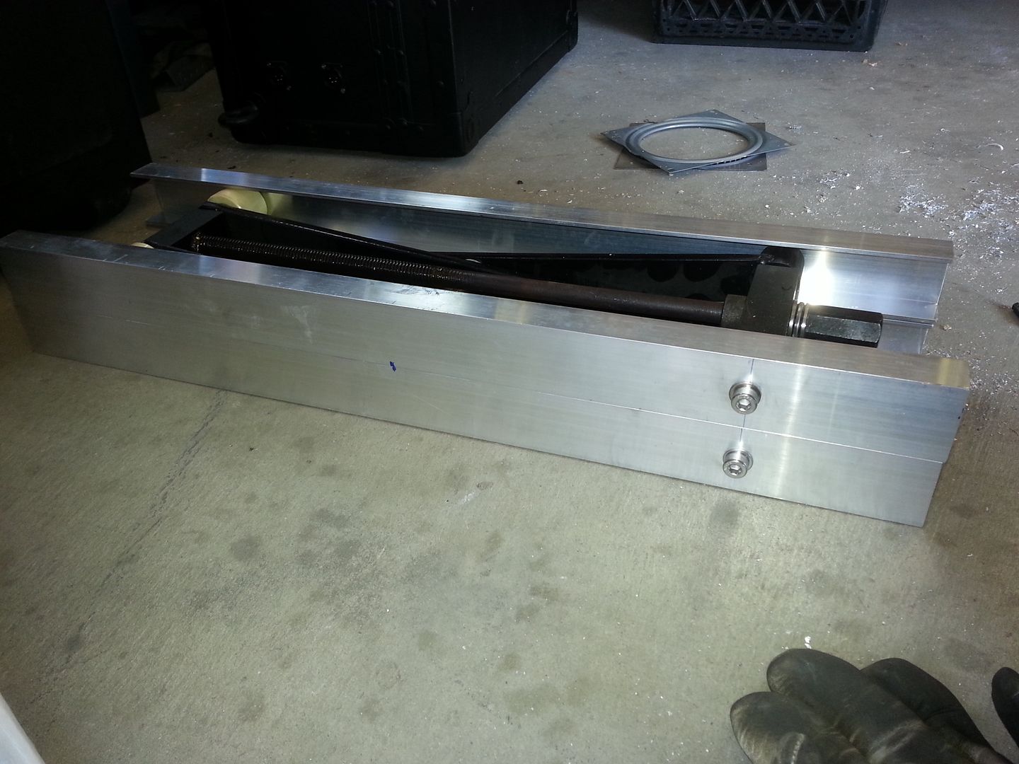

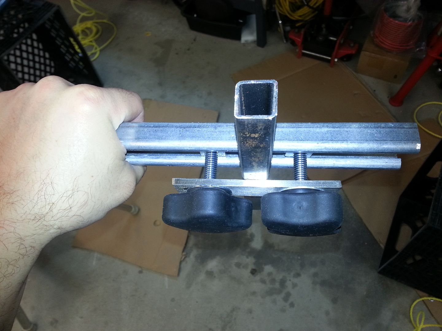

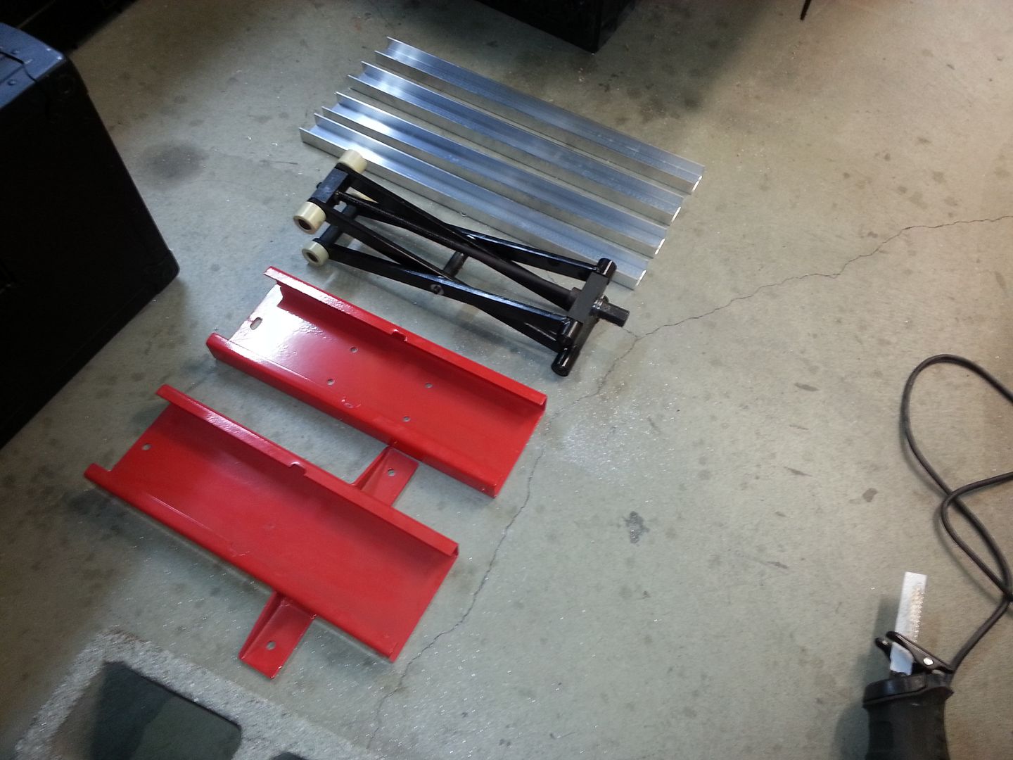

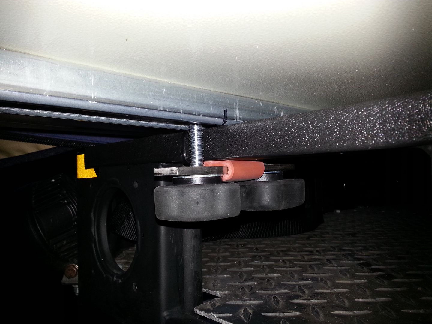

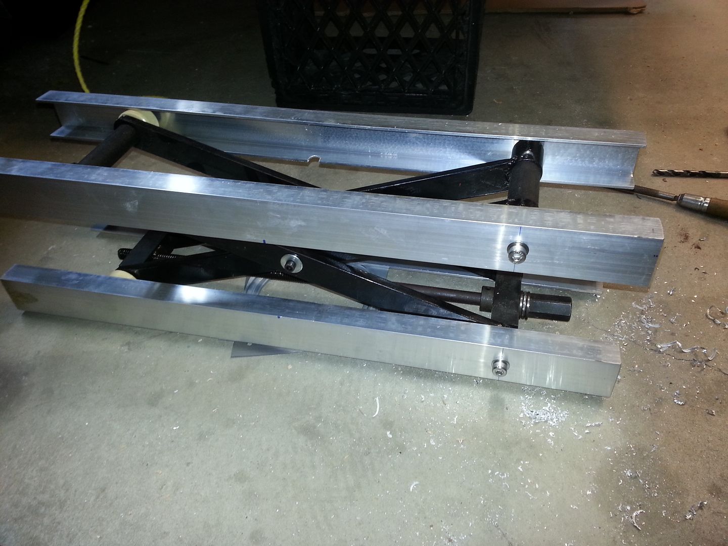

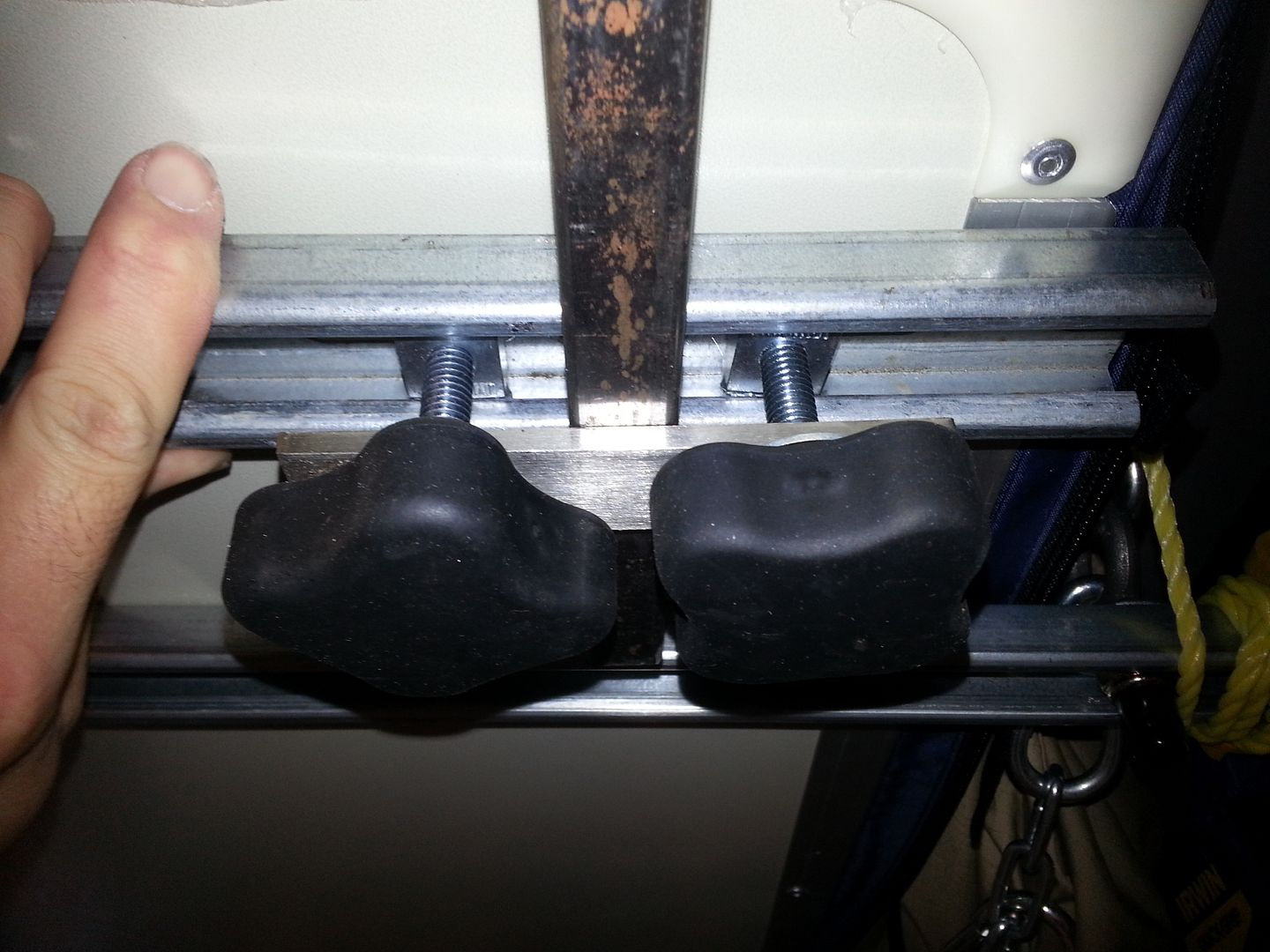

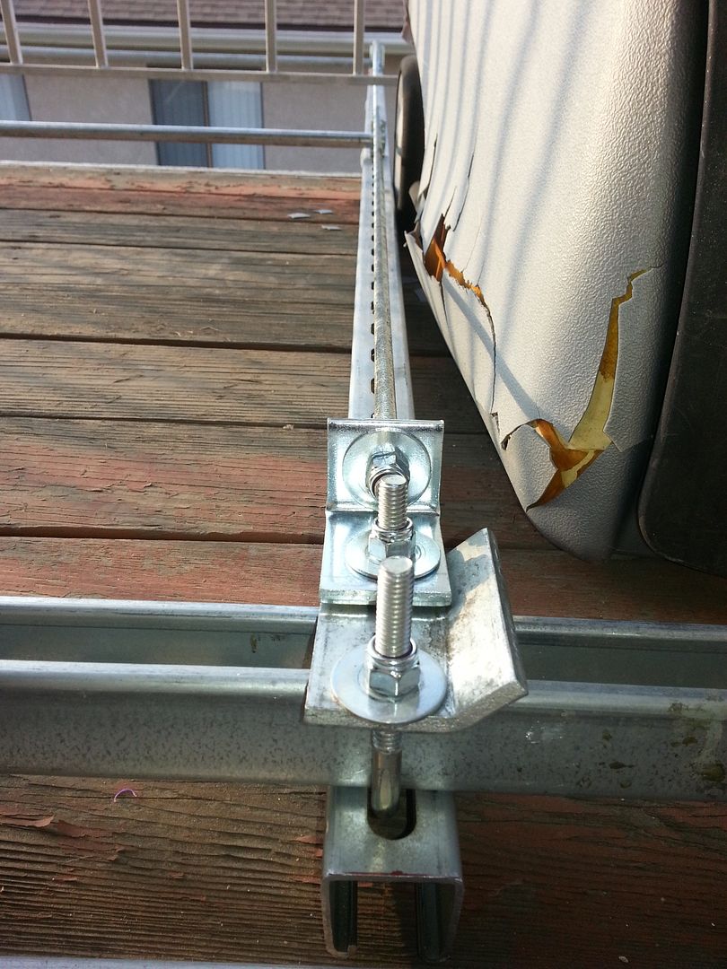

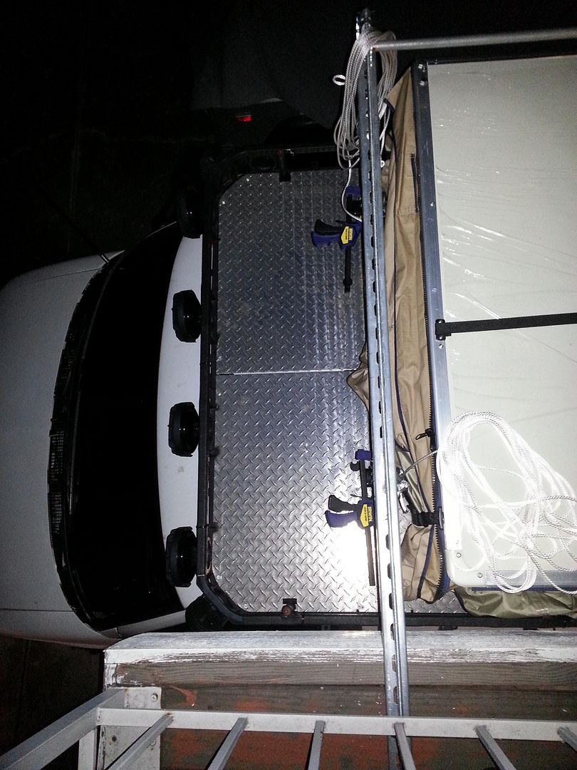

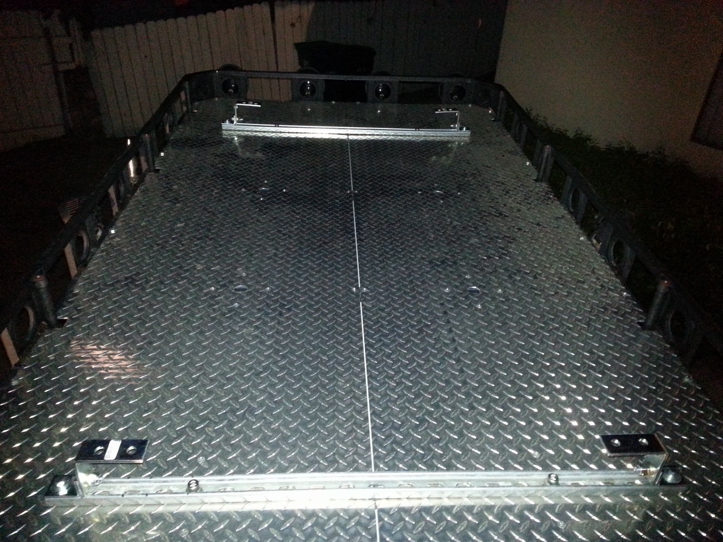

Once I knew where the tent would sit I made some mounts to secure it for driving. Four corners bolt down and the jack is slightly raised to support the center. The mounts:
The rails rest on brackets and then a threaded knob secures it:

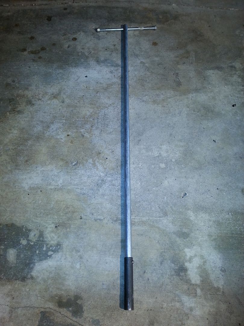

I made a really long handle for the jack:
It would look a little more tidy with the travel cover in place, but here is the profile:
Once I arrive at my destination the knobs remove, the tent gets jacked up a few inches and then rotated 90deg and rested on top of the rack rails. Then it's bolted down with these:
I added some awesome edge trim to the top of my rack rails to prevent the paint from being scraped off. It also allows me to easily slide the tent into position.

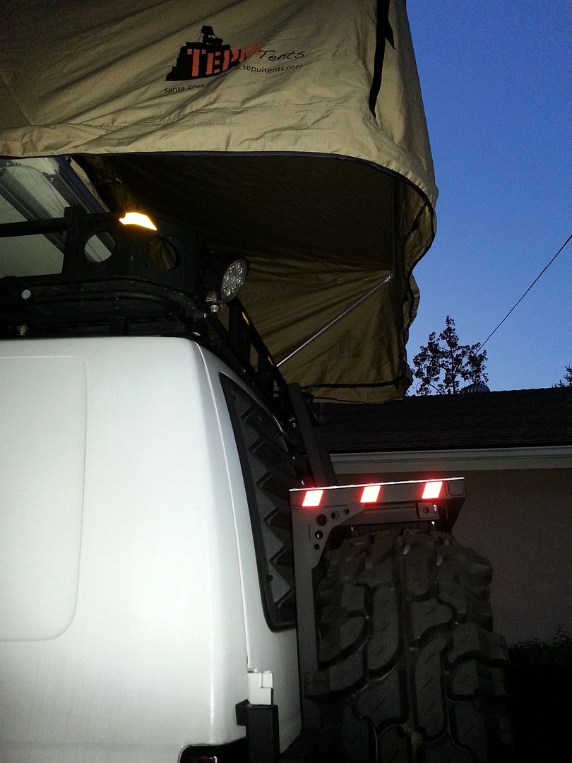

There is an awning outside the door of the tent that perfectly overhangs my tire carrier/ladder.

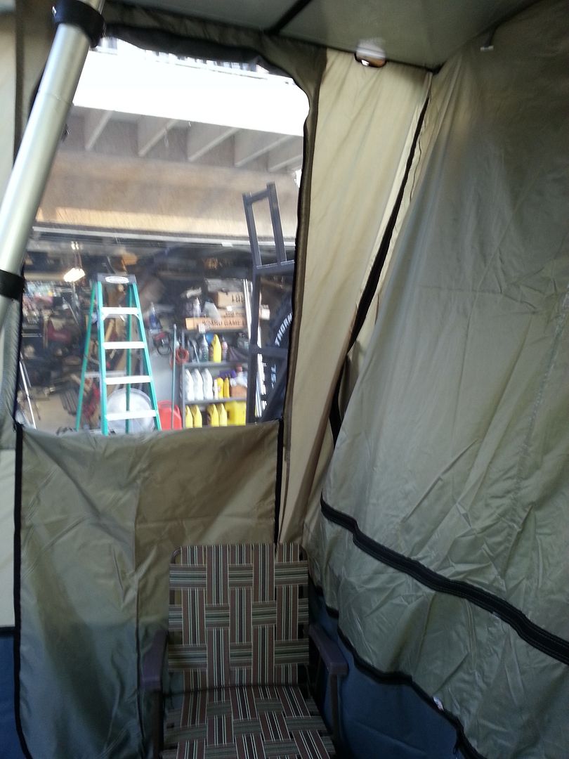

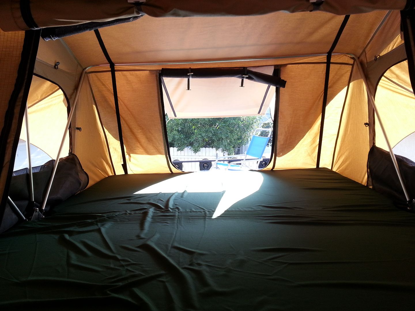

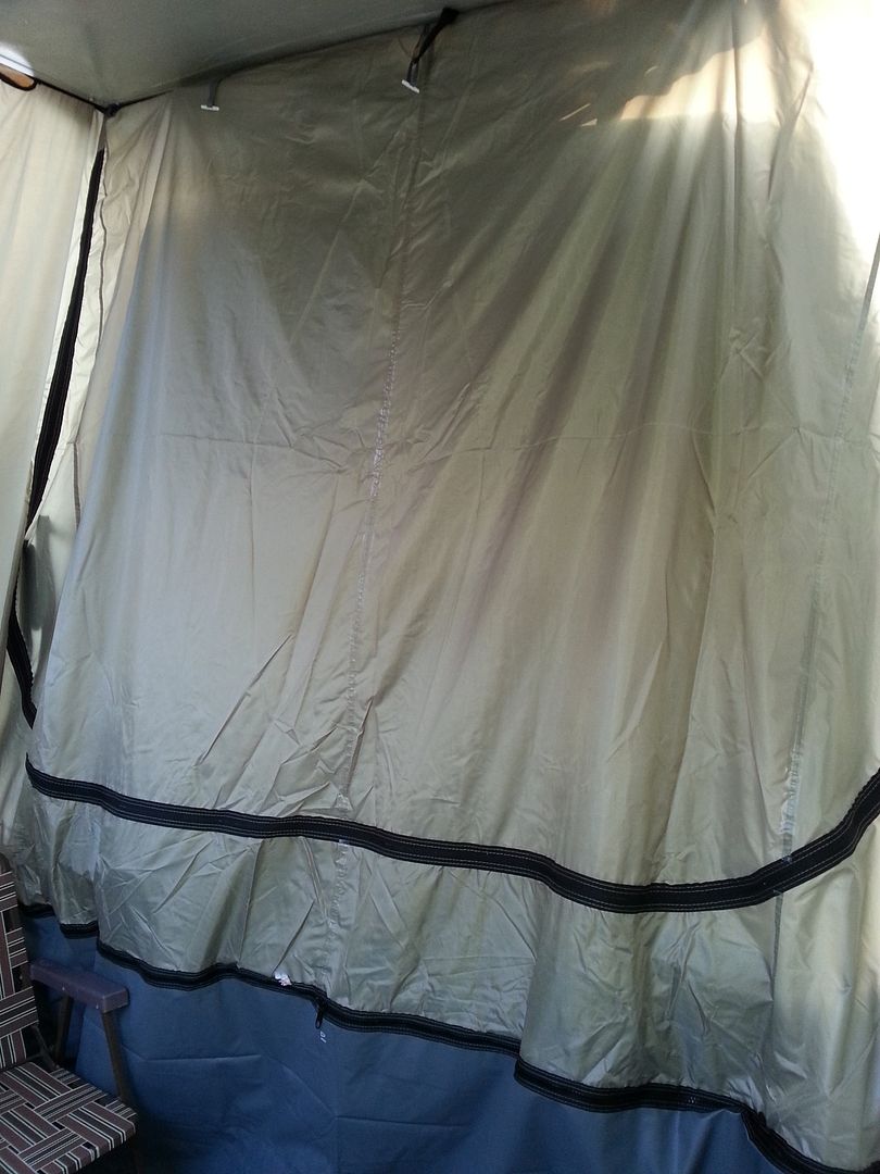

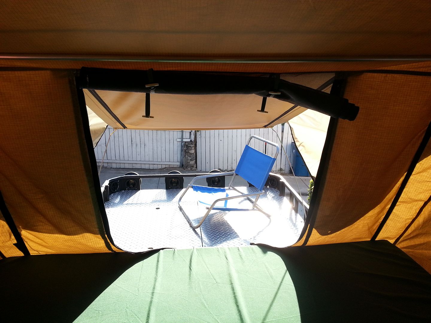

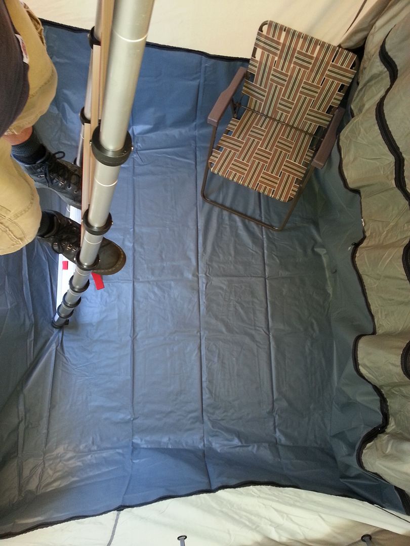

The tent is surprisingly large inside, even for a four man tent. In my experience a four man tent means you can cram four dudes in it but damn, who'd want to? This tent has room for four warriors and a harem. It's roomy for sure.
I have a nice spot outside the front door to put shoes on:

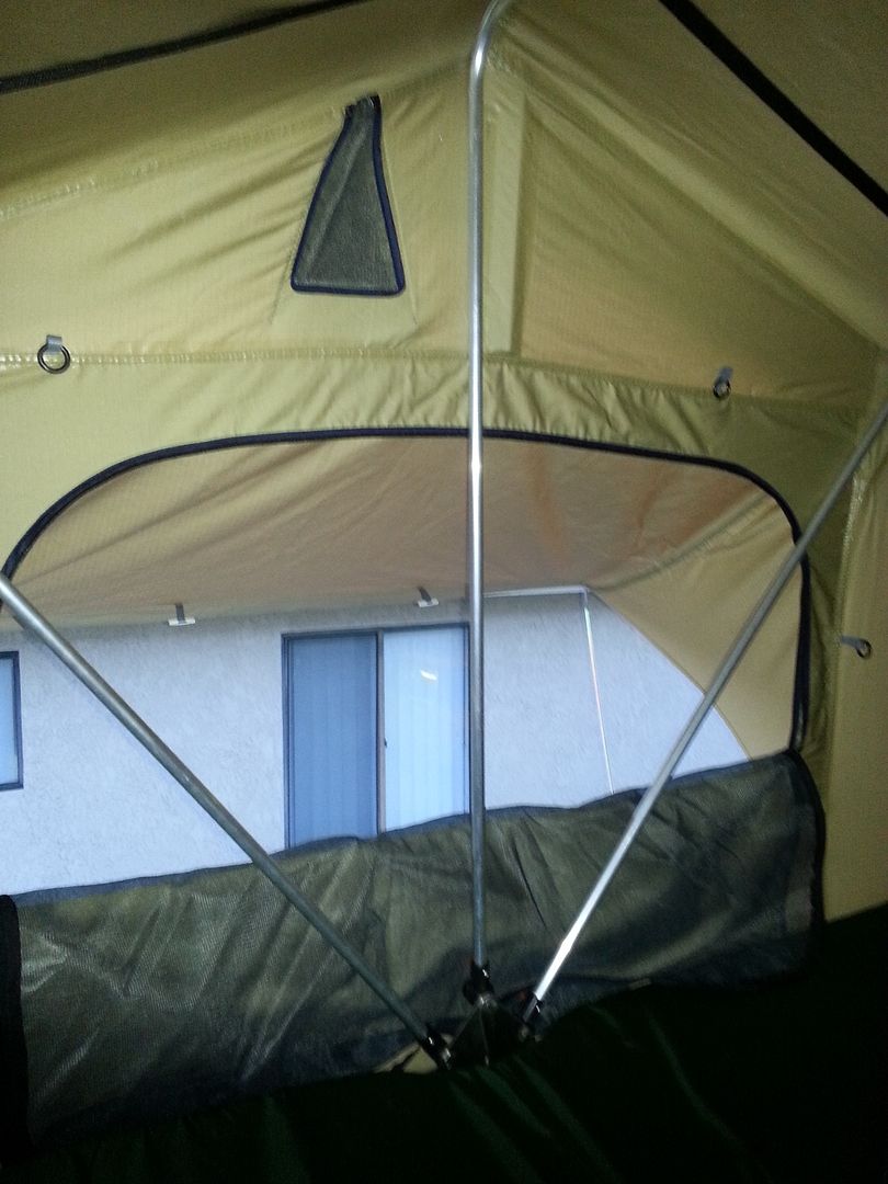

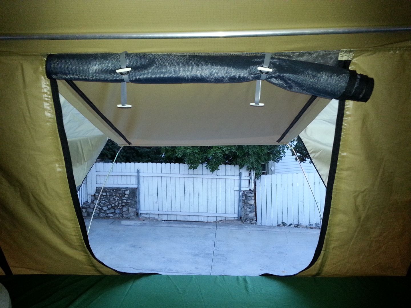

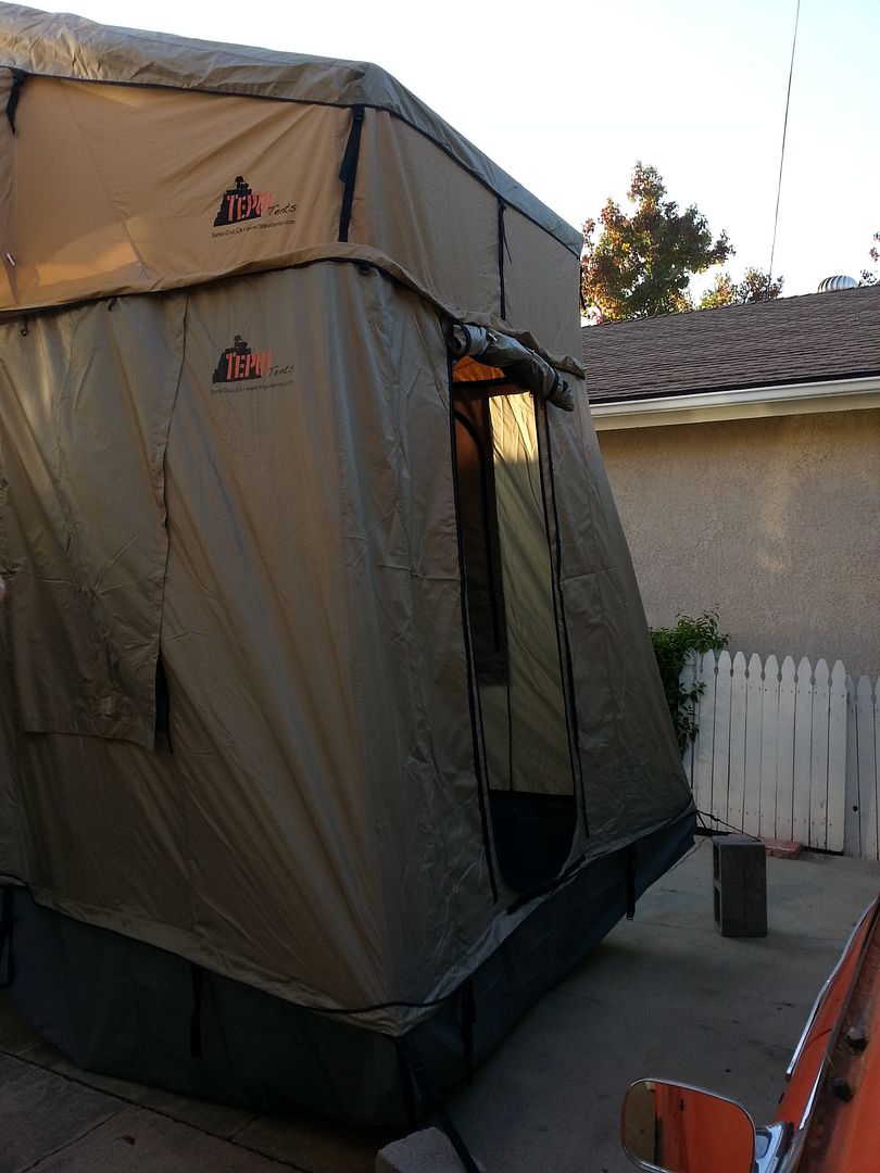

The tent has a front and back door and two windows on the sides. All completely unzip and can act as doors but the window sides have poles in the way so it would be tricky to enter there. Still its a nice feature knowing you have four potential exits. Or in case you need to whizz and don't wanna crawl over anyone sleeping. The windows and doors all have mesh screens that unzip and tie up and a panel on the outside that unzips and ties up.
The front door and both windows have an awning held by metal rods separate from the solid and mesh panels:

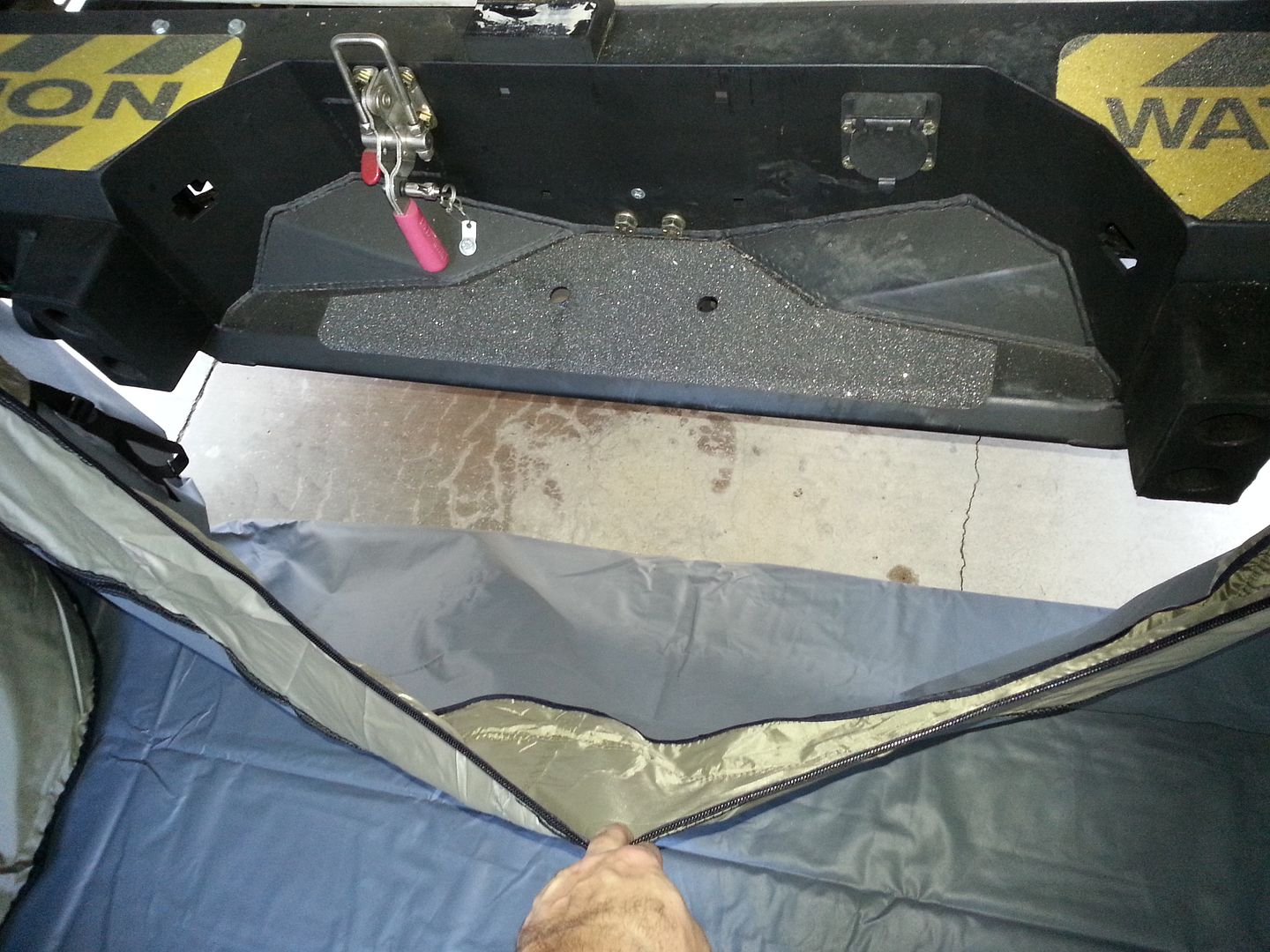

Back door (side without huge entrance awning) uses the solid panel as the awning which kinda sucks:
The rain cover also needs to be untied to prop it up (they do provide some bungee cords though):

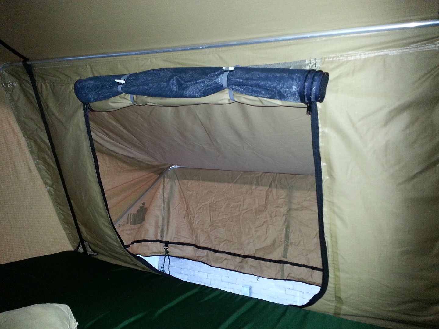

Some inside shots:
Notice the vent in the top:

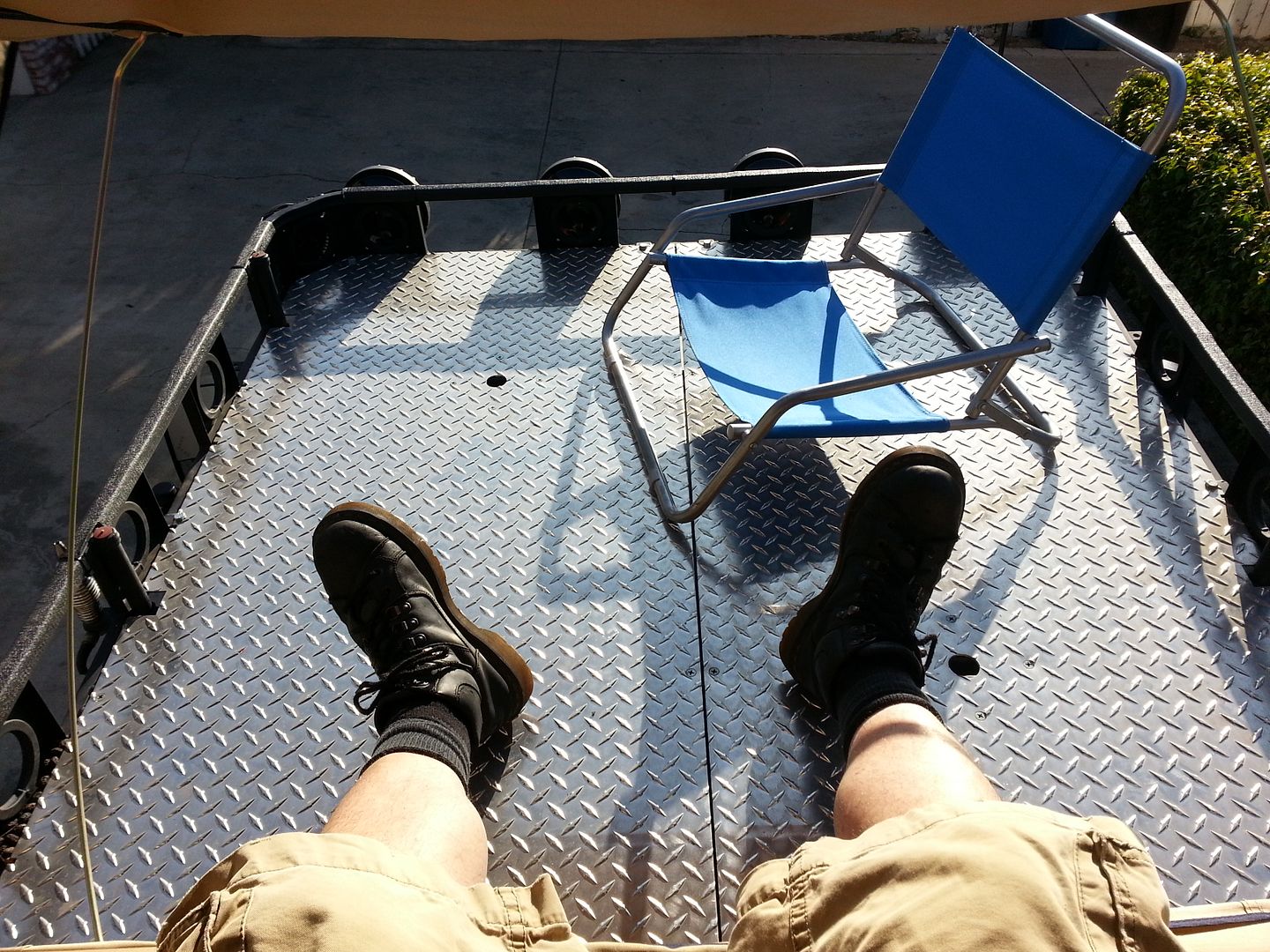

I took some pix with me laying inside to get an idea of the roominess with a 220lb guy inside...mmmmmmmnope. Not gonna show 'em. The tent comes with a 2" thick mattress that folds up with the tent and it's quite comfy for now. The bed doesn't seem much different than my CalKing bed in the house. It's big.

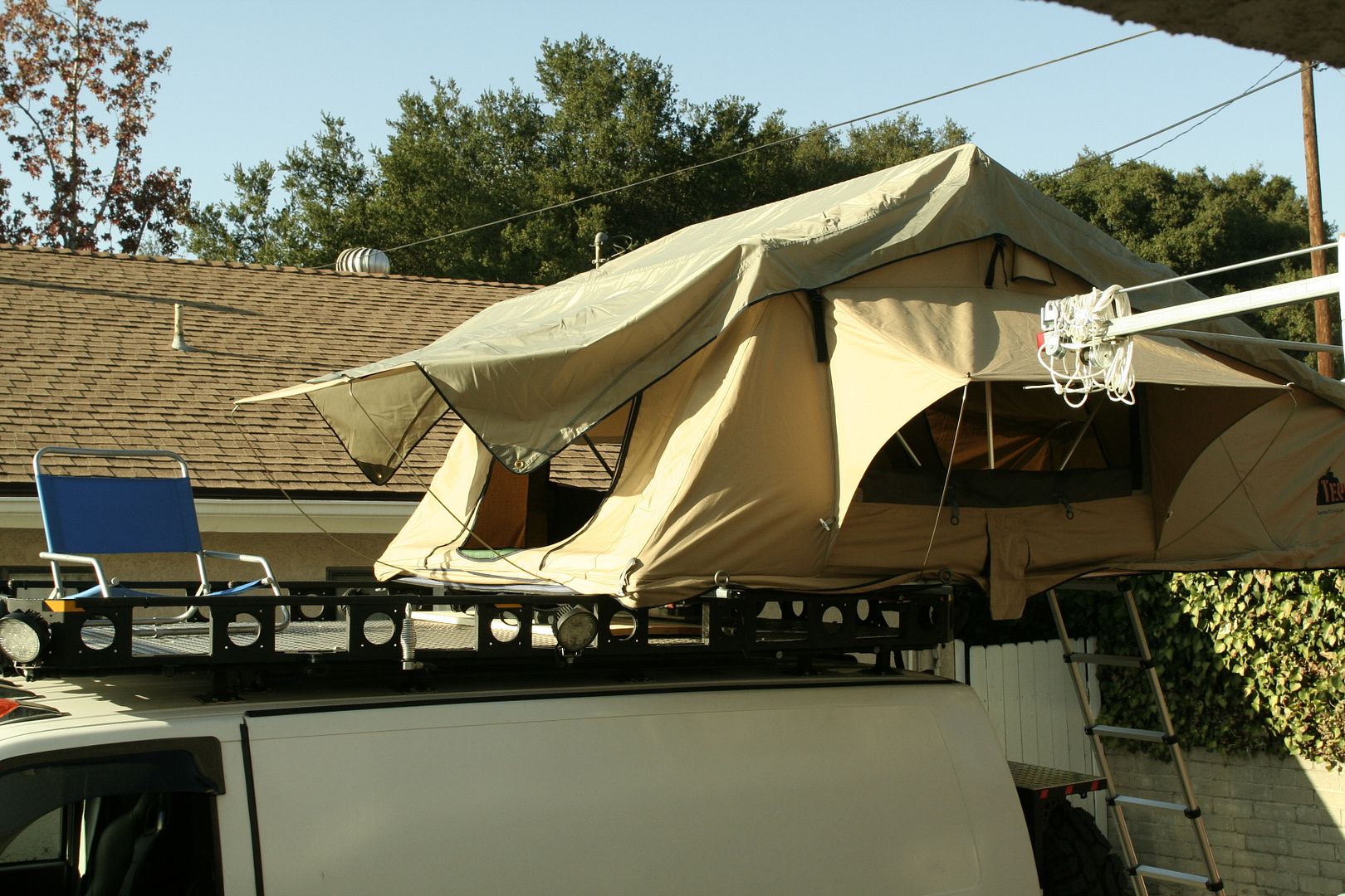

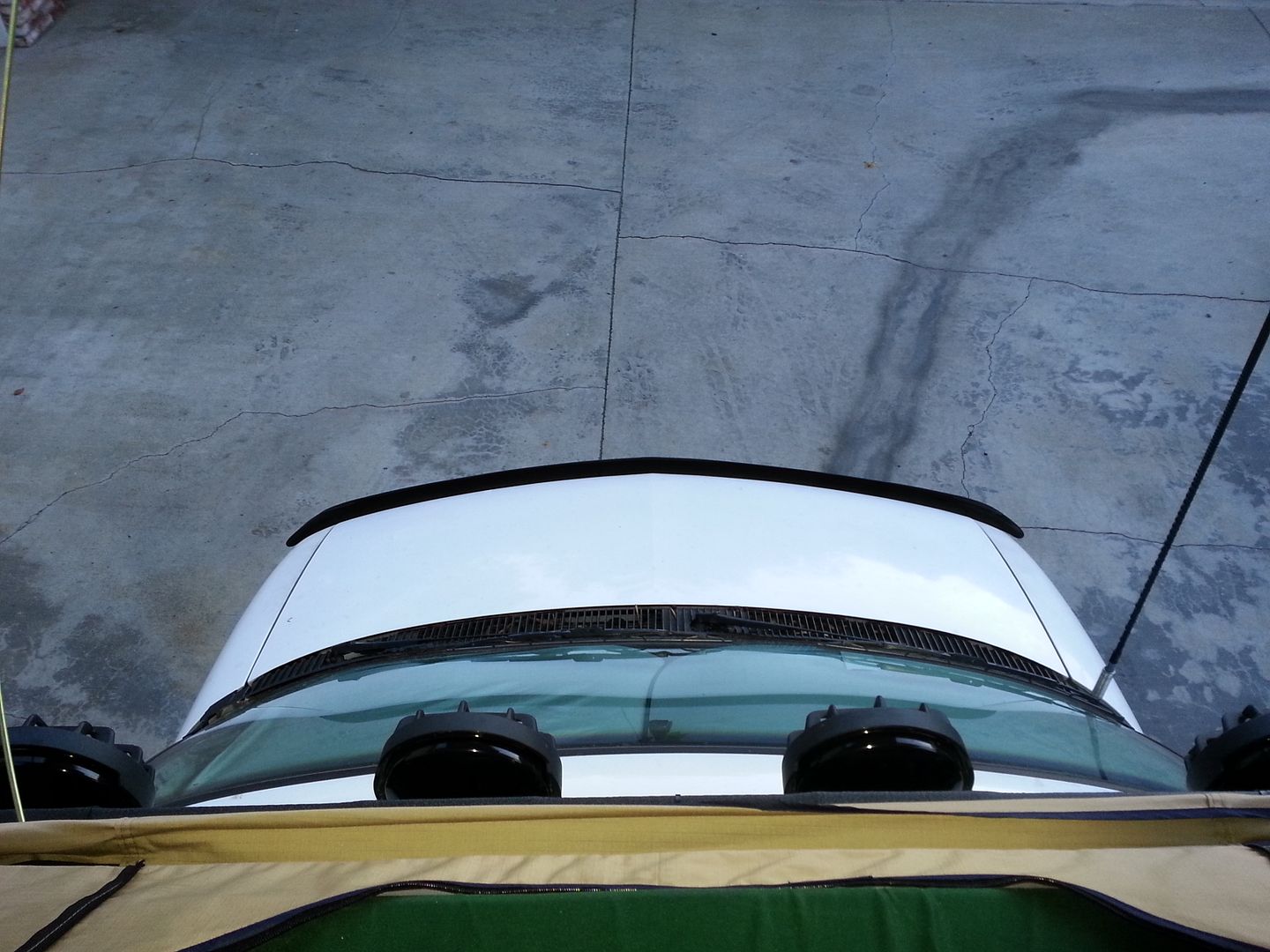

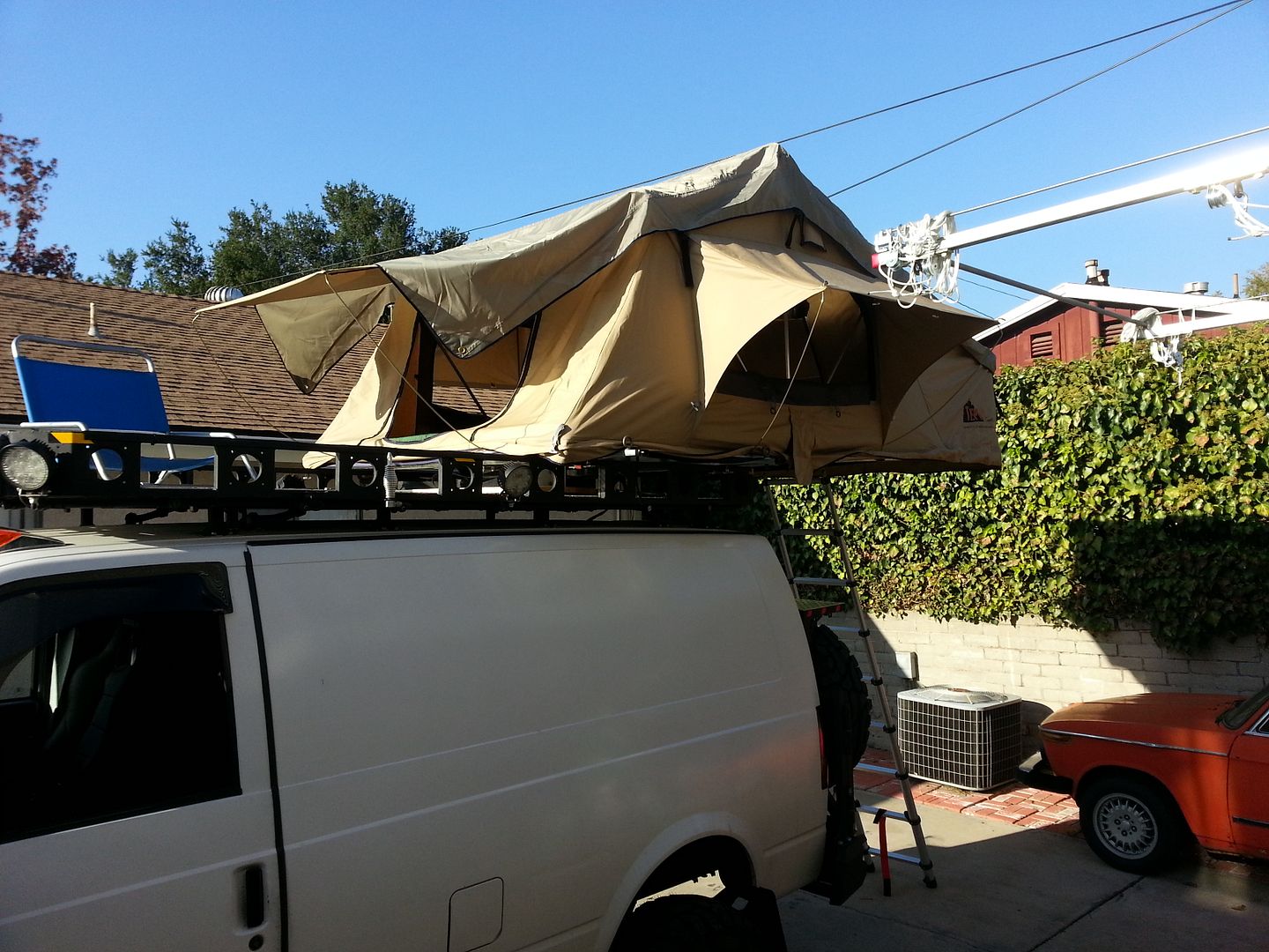

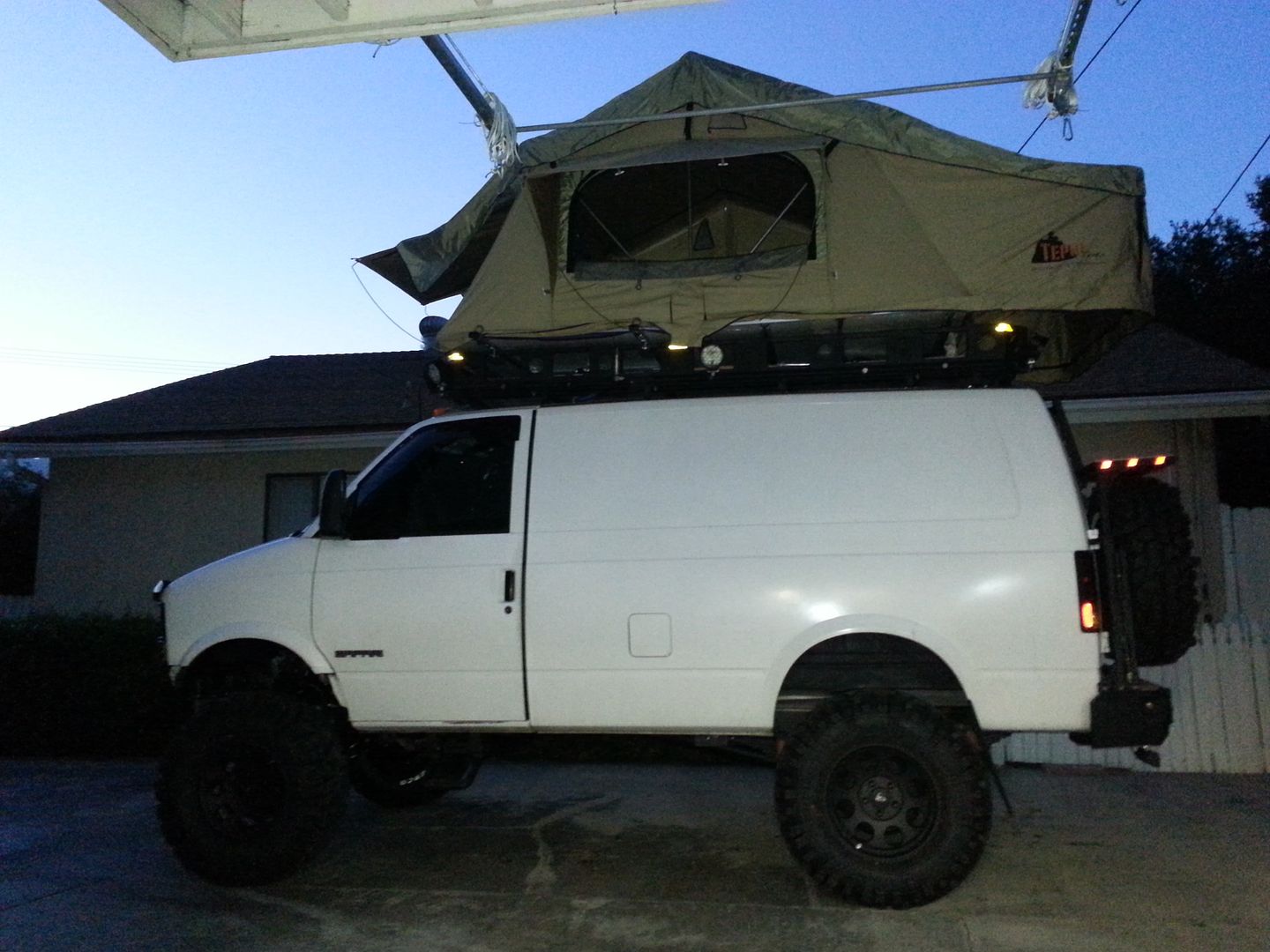

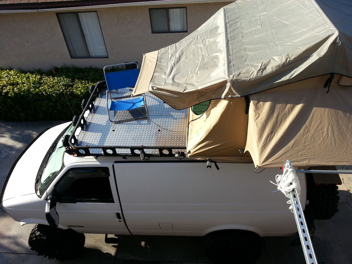

The second setup for this tent is with it mounted for overhang. This is the traditional setup, although mine is off the back. This setup gives me a 5'x5' patch of rack space to hang out, setup up beach chairs or whatever. It also means half of the tent is supported by the ladder which I find creepy when you're more than 8ft. off the ground. The ladder may be more sturdy when its not fully extended on a shorter vehicle but for me it's at it max extension and its scary. I was able to climb it with it flexing and get into the tent but I did not feel safe. I definitely would not have anyone else in the tent with me with the provided ladder holding it. I will need to find a new ladder.
Here it is:
The extra space is nice to hang out...in case you never wanna touch the ground :roll:
It would be cool to park in a river and fish off the roof!
You could fit two chairs outside.

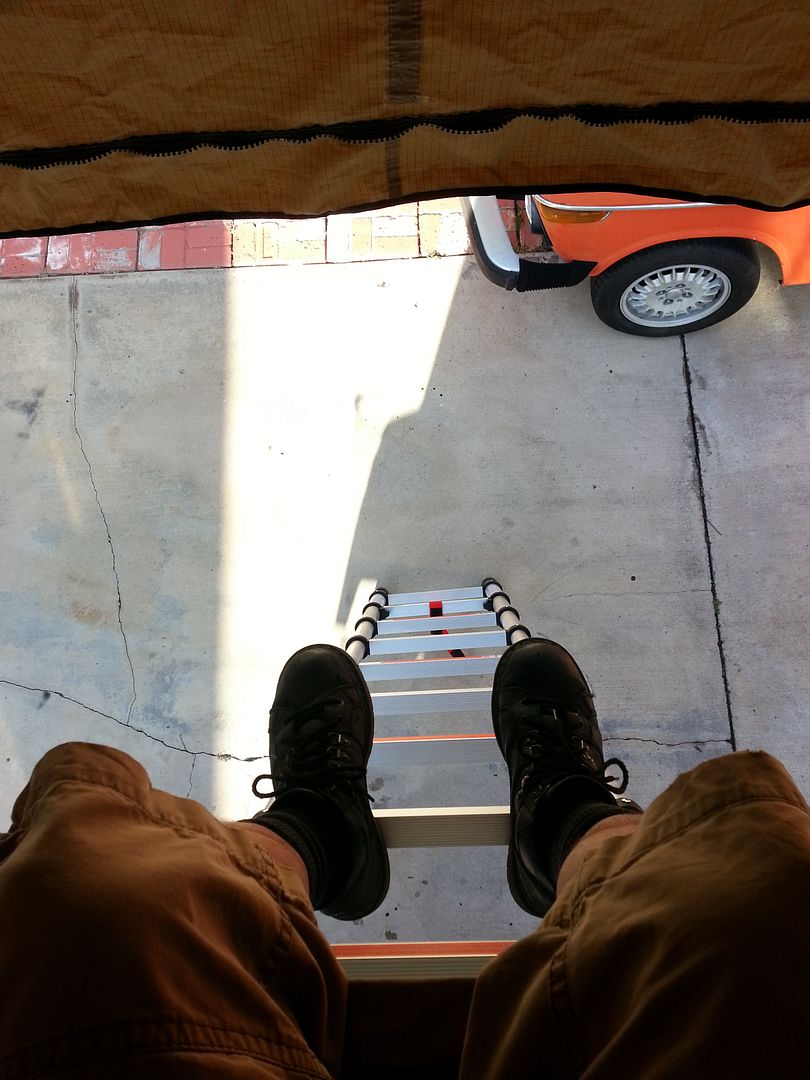

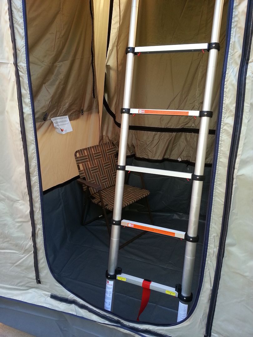

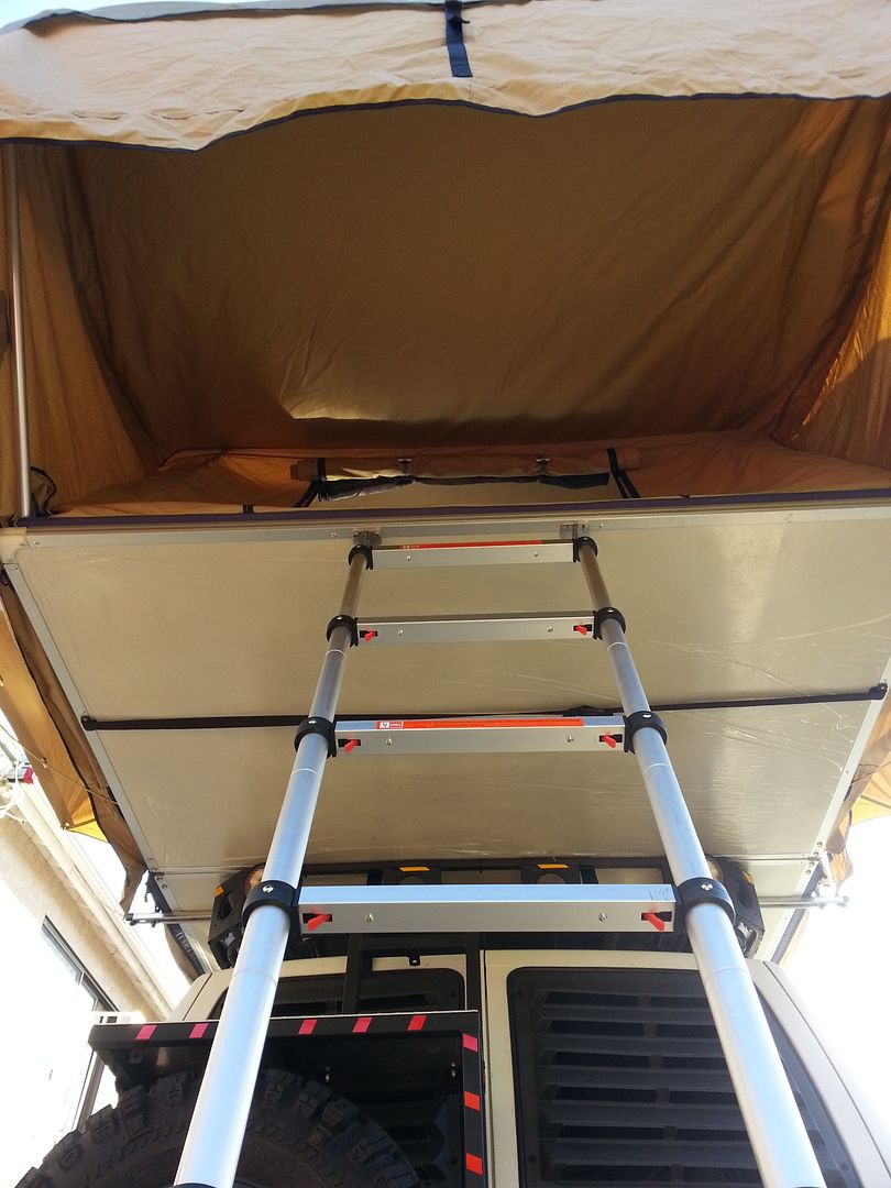

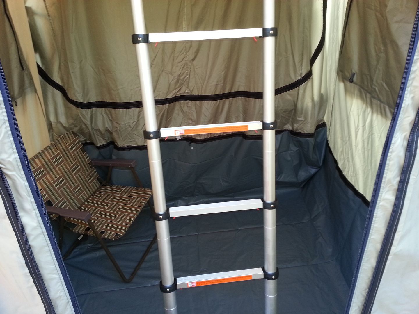

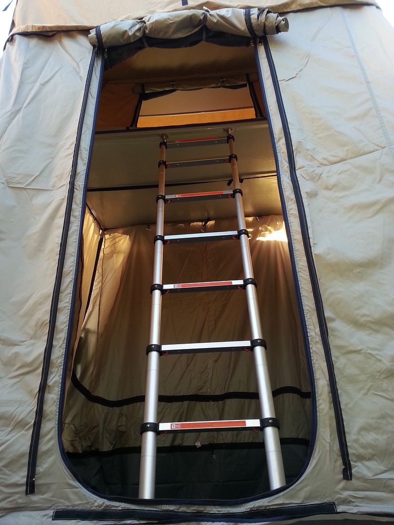

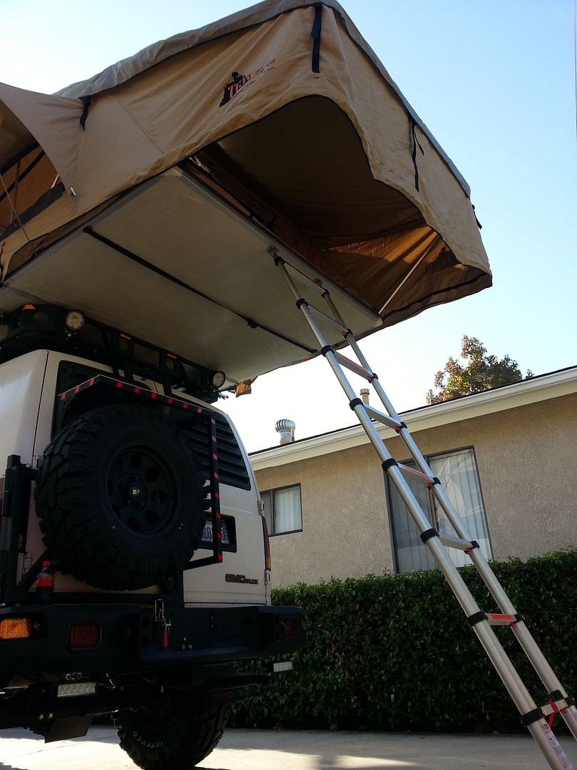

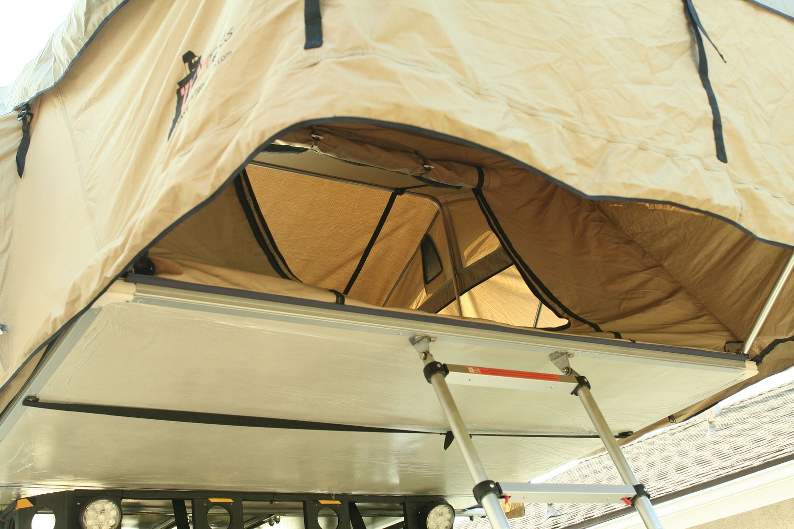

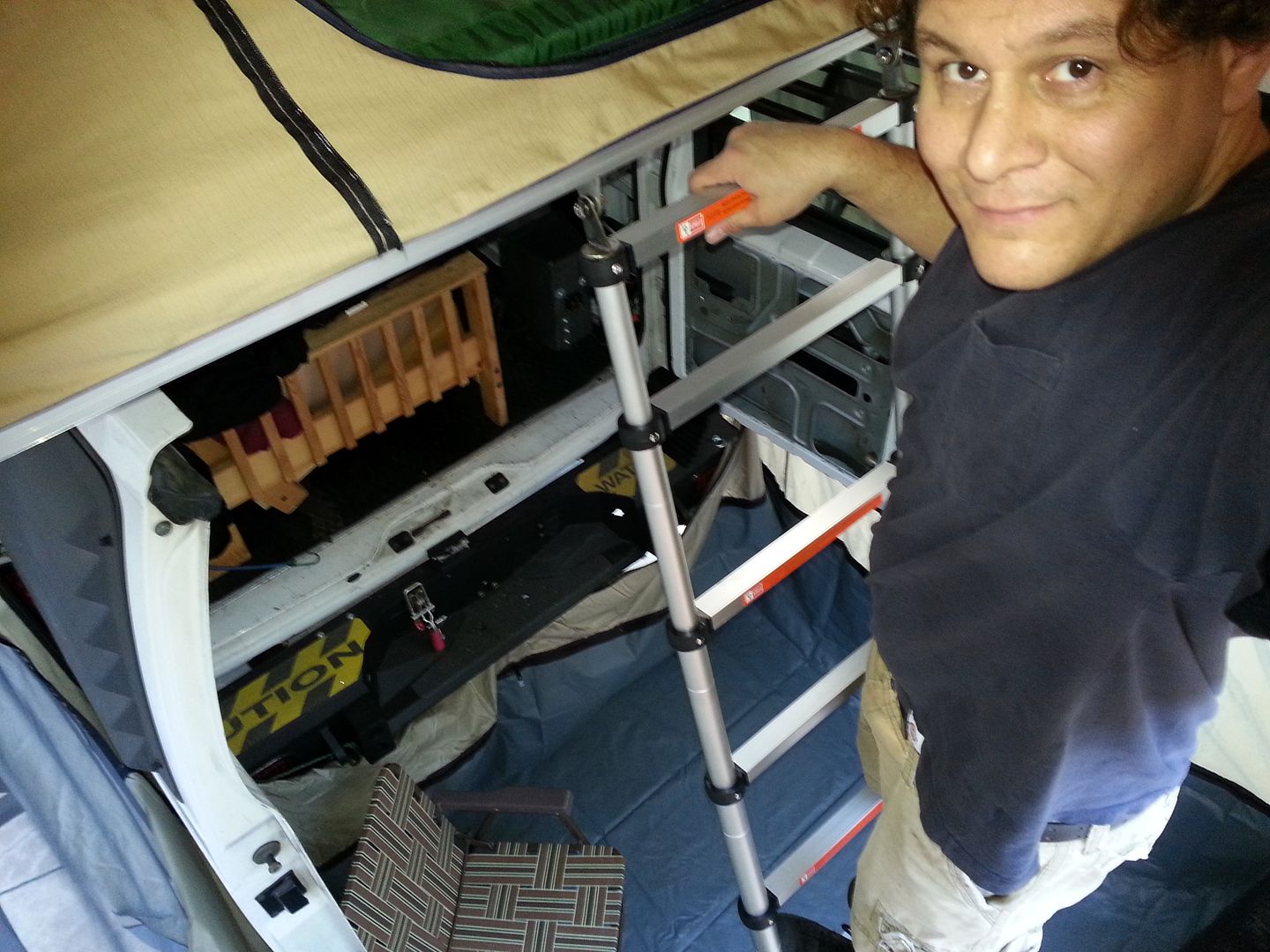

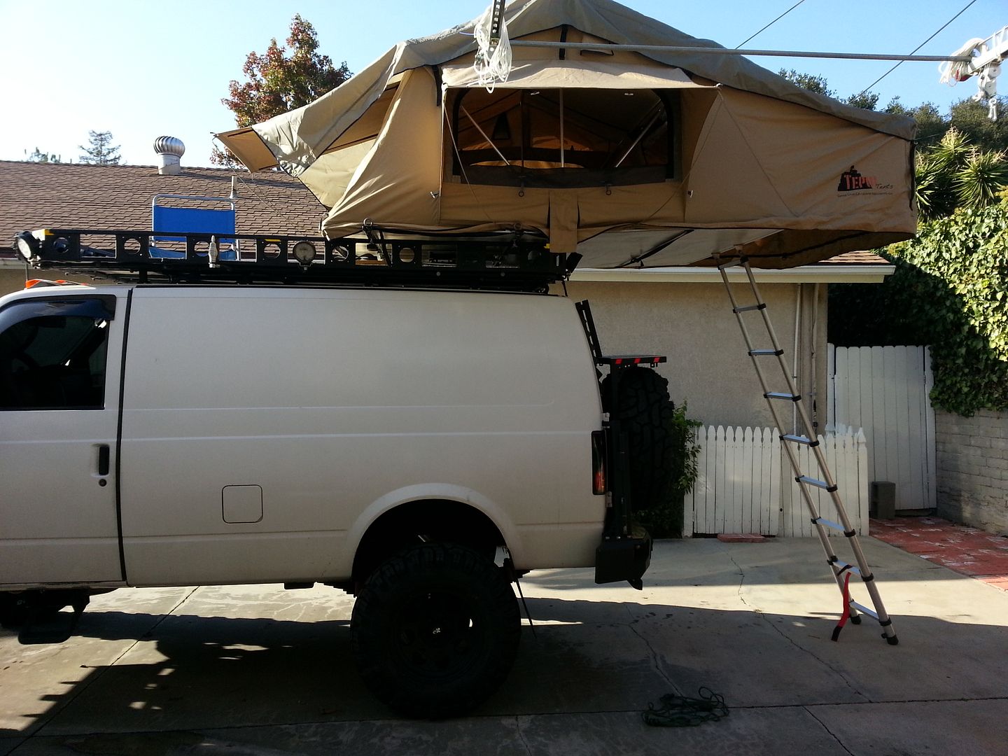

The ladder is crap:
At this height you really want something to grab while going up or down:
It's a long way down to fall in the middle of the night!

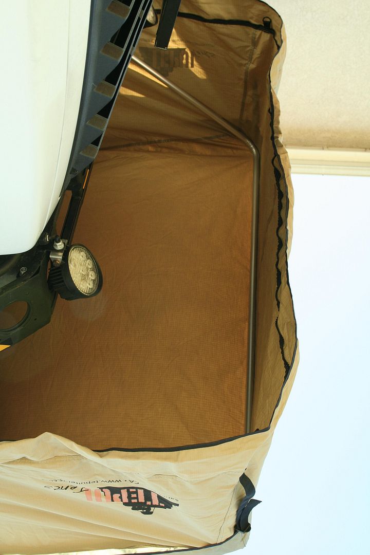

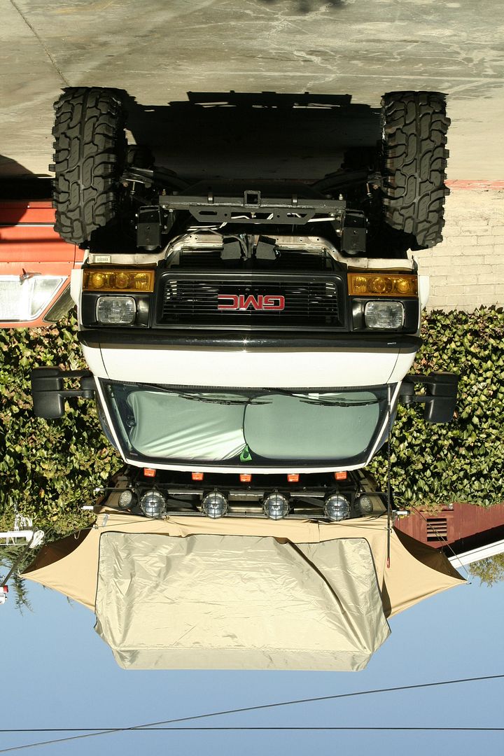

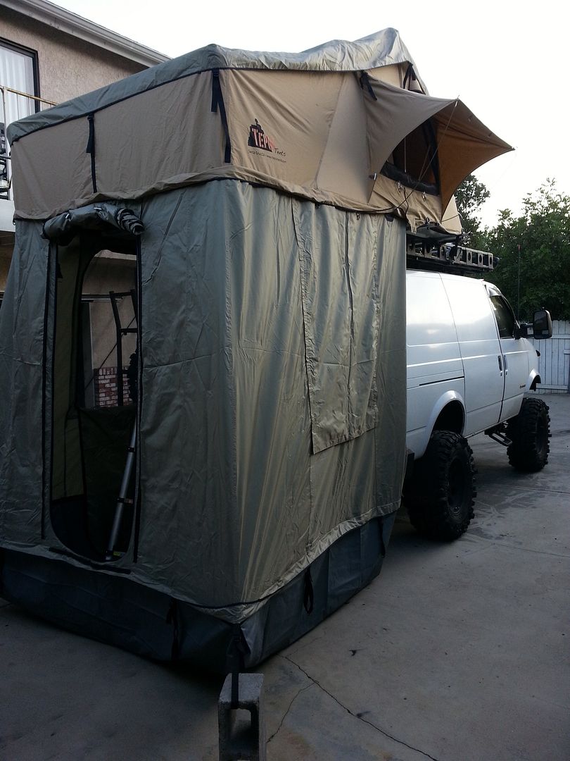

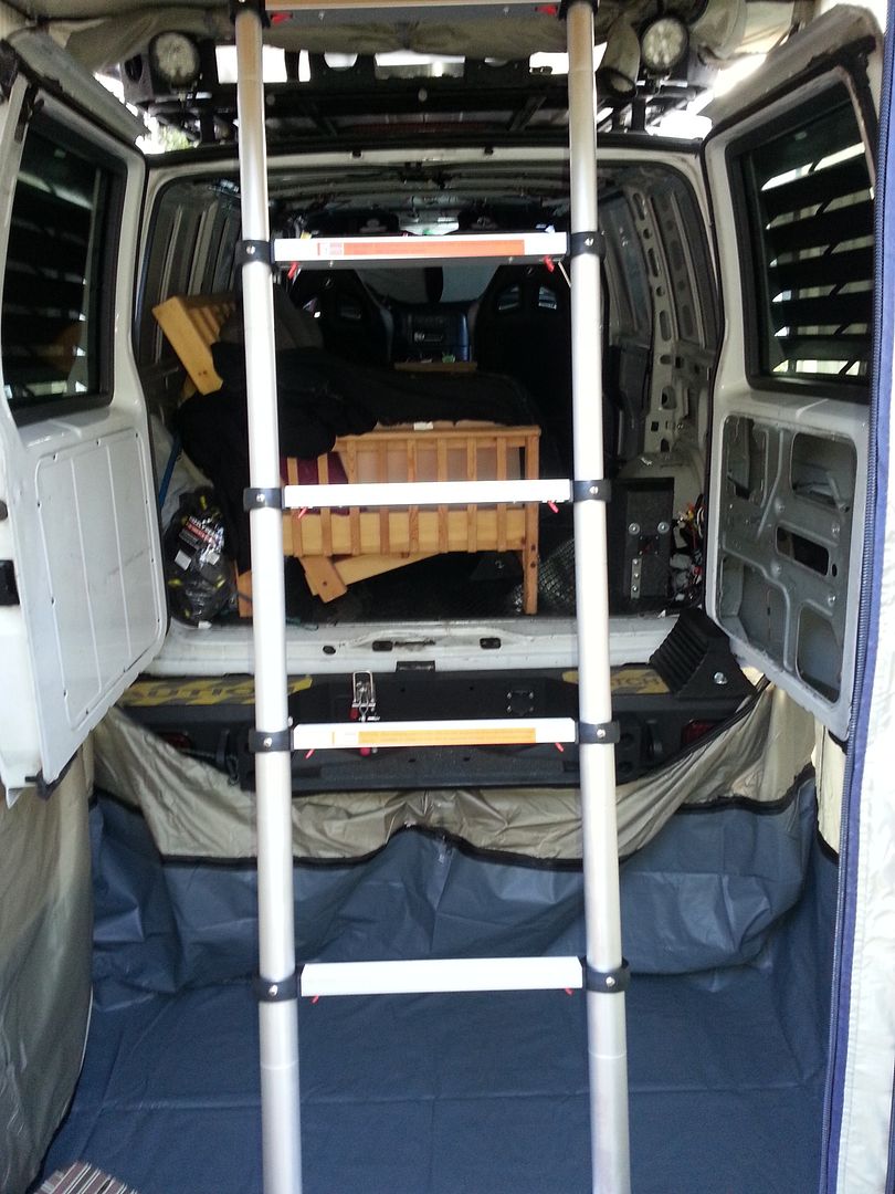

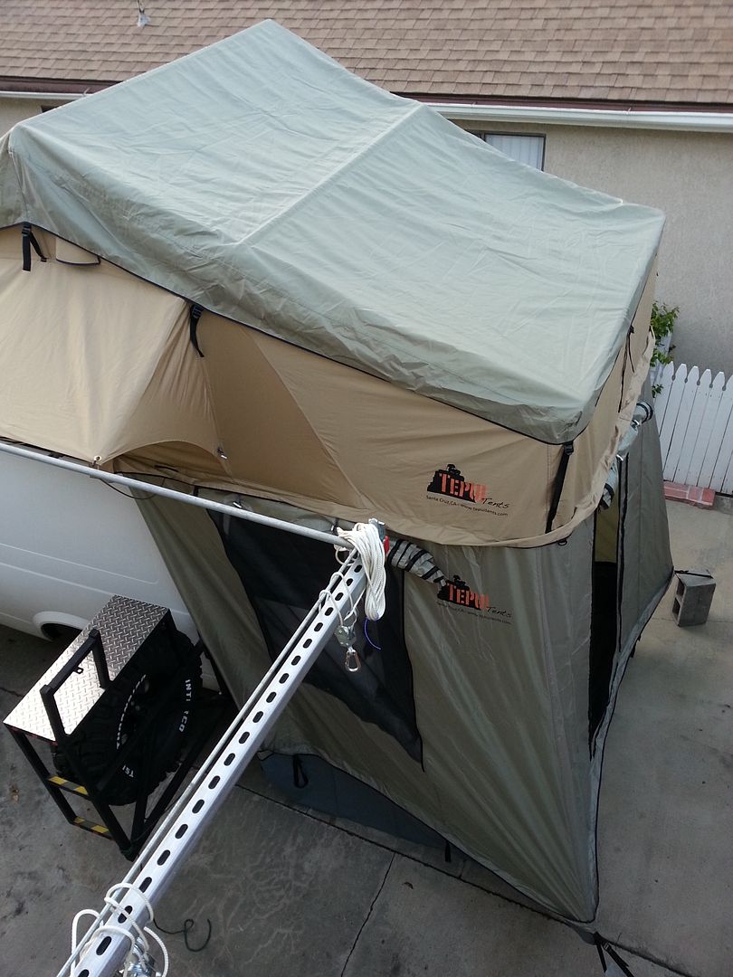

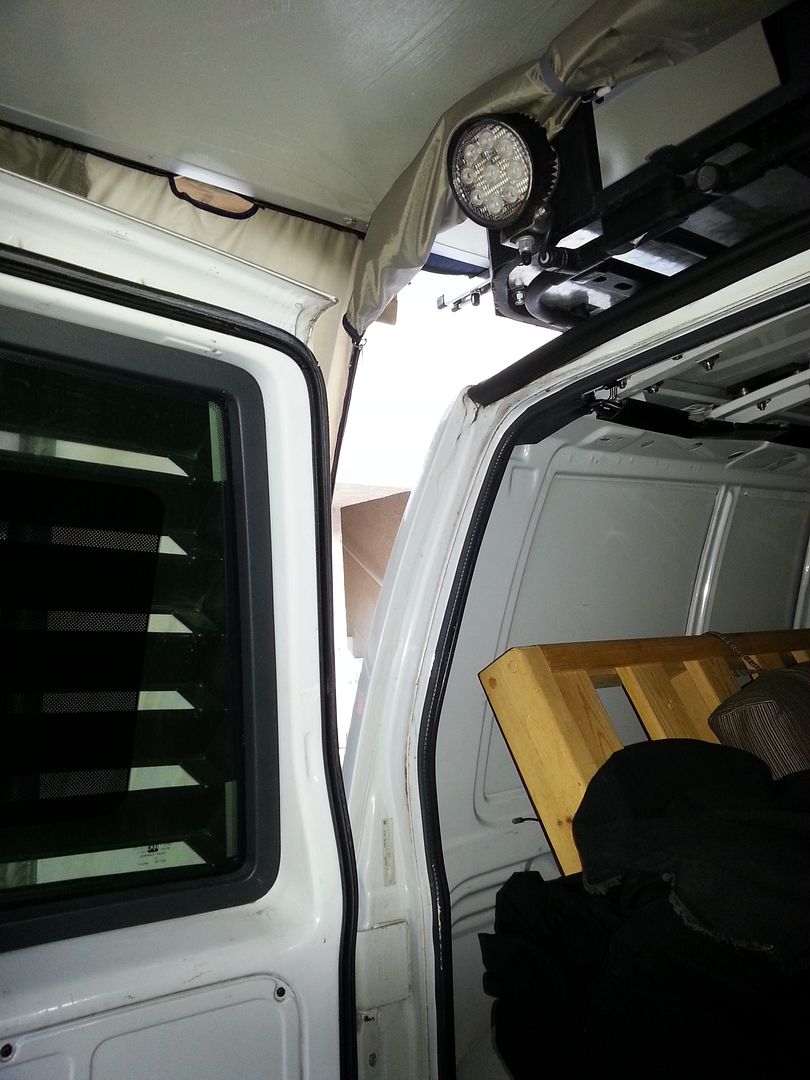

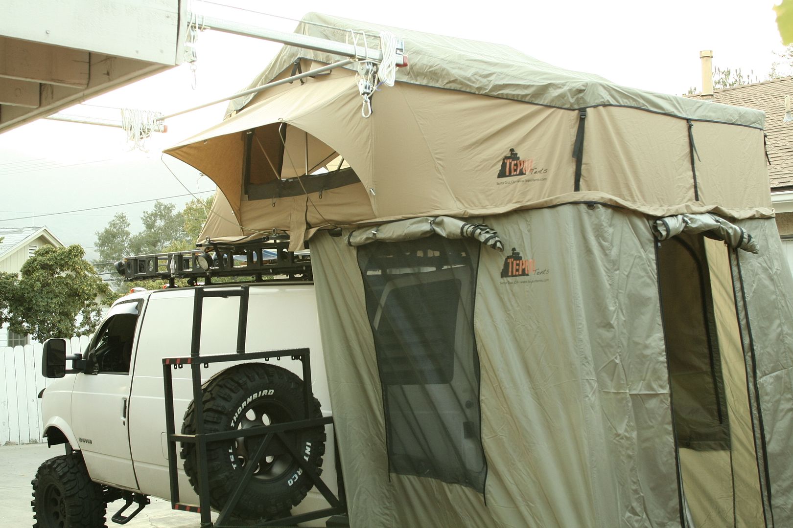

The third setup is with the annex zipped on. It was a major PITA to try and figure out how it went on the first time and I had to use a ladder because the van is so tall. But the annex is awesome!
The floor area is diminished due to the height of the van but its still surprisingly large.

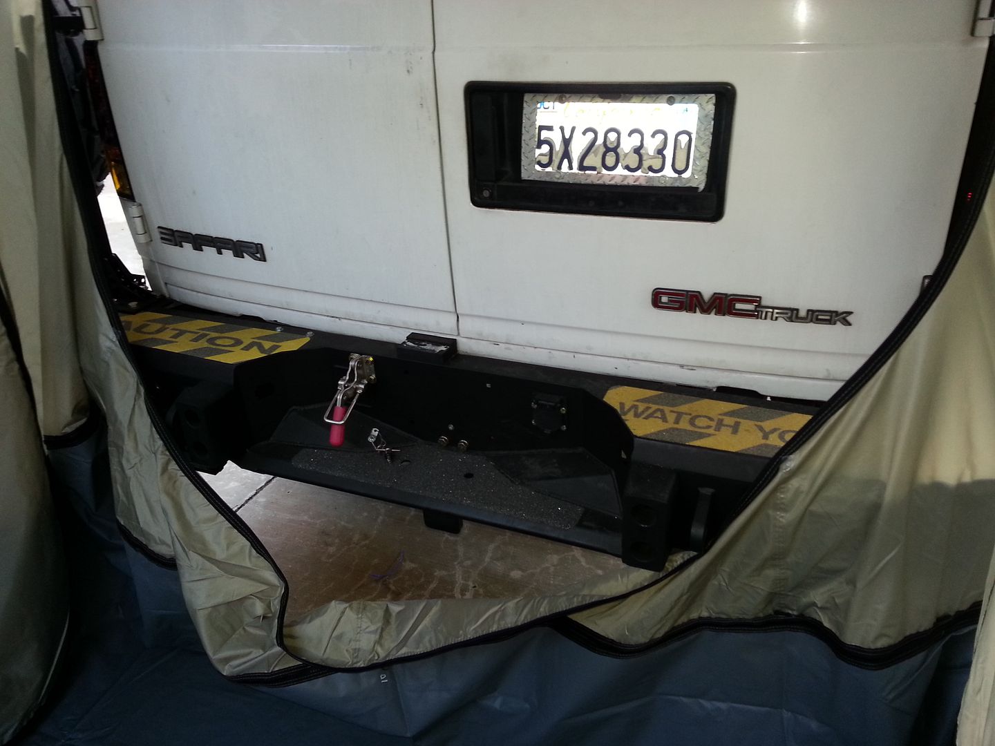

There is a large vehicle access door too:
It does allow critters to get in though:
The annex would be a great spot for a shower. You can also fold up the ladder if nobody is in the tent and have some extra space.

That ladder is one of those telescoping one's. I've got a 12' one and it does flex a lot, I've had a few 200-240 lb guys on it over the years. It's aluminium so yea it's going to flex, and keep in mind, round tube is stronger the square tube.
