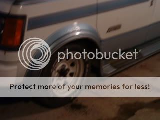

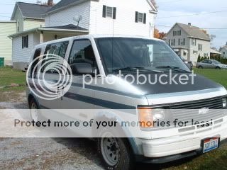

Another member and myself were talking about them so I am posting some pics of mine.
no r/b
with
Image ImageImage
I took them off due to rust and hitting something and doing this to the fender
So they need some repairs that I haven't built the confidence to try yet. I have never worked with fiberglass so any tips or tricks would be fine by me

Postby Mr_Bowtie » November 1st 2009, 2:34am
No tips or tricks here, but I just wanted to say without the running boards you Van would have more rust then it does. My Astro didn't have running boards and its all rust. My Safari did(I took them off) and it has way less rust issues. Both of them have always been kept in WI too.

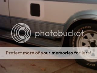

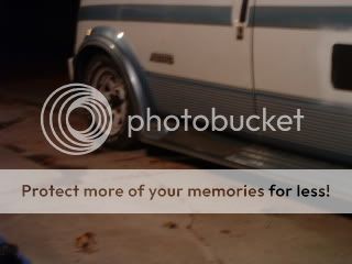

Postby 90lownslow [OP] » November 1st 2009, 6:19am
i confess. my van has no rockers. that isnt a good pic because there is no bottom piece at all. thanks for the tips
