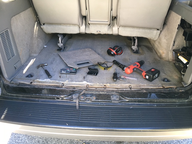

Bought me a 2005 Astro and it's a keeper. The interior is mostly fine with some scuffs and what not, but there is a smell. I believe it is coming from the floor carpet, which has received the worst of the wear. I'm going to pull it up, make sure the bare floor underneath is clean, then install lots of sound deadening and a new carpet.
I am finding it extremely difficult to remove the carpet, as the trim screws are rusted and full of muck and sand, such that it has proven nearly impossible for a good screwdriver to find purchase on the screw heads. My screw extraction attempts proved somewhat fruitless as well, so I wound up ripping the plastic trim piece out in the hopes of getting some locking pliers on them.
I'll spare you the cursing. Question: Where can I buy the trim screws that hold the carpet in online? They're not standard screws, and few of them are in good enough shape to go back into the car. The places I've found only had larger parts and wear items, and the prices did seem crazy. Is there a comprehensive fiche I can peruse for part numbers?

They are just sheet metal screw with a steel standoff under the plastic so it's not crushed. i replaces all my trim screw with Stainless Steel self-drilling sheetmetal screws. Just don't tighten the crap out of them and you'll be fine.

I hit up Lowes for several Diameters - close and one size larger - several lengths and also purchased a variety pack of Stainless Hardware - countersunk and otherwise in those sizes.
I was able to get ALL OF THEM out using "Mystery Miracle Oil", 6 different Phillips drivers, lock-ease, pb blaster, hammers, impacts, etc, etc, etc.

They're Posi-Driv, not Phillips. That's problem #1. Problem #2 is, if the carpet has ever gotten wet, they're rusty. Problem #3 is they were overtightened at the factory.
In short, they suck.

Wait, Posidriv?? I swear I checked for the marks...Bah, they were all too damaged.
I've gotten most of them out with the same symphony of chemicals and machinery...PB Blaster, impact driver, fresh bits, clawhammer...
I don't quite have the carpet out, but from what I've seen, the entire pad underneath is soaking wet. The floor underneath is clean paint. I'm aware of no leaks, but there must be something...
I'll get some stainless screws as a last resort, but it would be nice if I could get the real parts. I think I'll also need some rubber/adhesive strips for under the trim.

Leeann_93 wrote:They're Posi-Driv, not Phillips. That's problem #1. Problem #2 is, if the carpet has ever gotten wet, they're rusty. Problem #3 is they were overtightened at the factory.
From the "Never too old to Learn Something New" School.
All these years - never heard of them - "Posi-Driv". But that now explains how somehow I got this certain bit or screwdriver that "seemed" to work better than any other.
Thanks again, Leeann & Google :poke: . I'm off to check out my bit and screwdriver ends with a mag'g. glass. Look for "PZs" - Do some separating.
Uh,oh... may have to buy some new bits n' stuff.

I got lucky - they're in a set my husband gave me years ago.
I was cussing at the damned things in the '99 years ago...and pulled out the FSM to find out they were PZ, not PH. Well, heck.

Progress? Here's a quick frustrated shot after finally wrestling the carpet and soaked pad out of this thing. It seems like I need to remove the front heater core to get that last bit of carpet out, but I just cut it. Bah. Kinda wish I'd taken the shot before throwing the seat back in, but I'm not exactly blazing trails with the work I'm doing here...
I was happy to find a mostly clean floor. No visible rust, though possibly some bubbling from where rust has begun underneath the car. I plan to spray the whole underside with Fluid Film in the next few weeks, so hopefully the rust will stay in its minimal state going forward.
On to cleanup and sound deadening...My search also begins for a pair of bench seats that fold all the way down in place of my LT seats.
Did these things ever come with black interiors? I would pay good money for a complete setup. I'm contemplating vinyl dye, but I fear any lingering smell, and I don't think I want to take apart the entire interior just to change the color.
