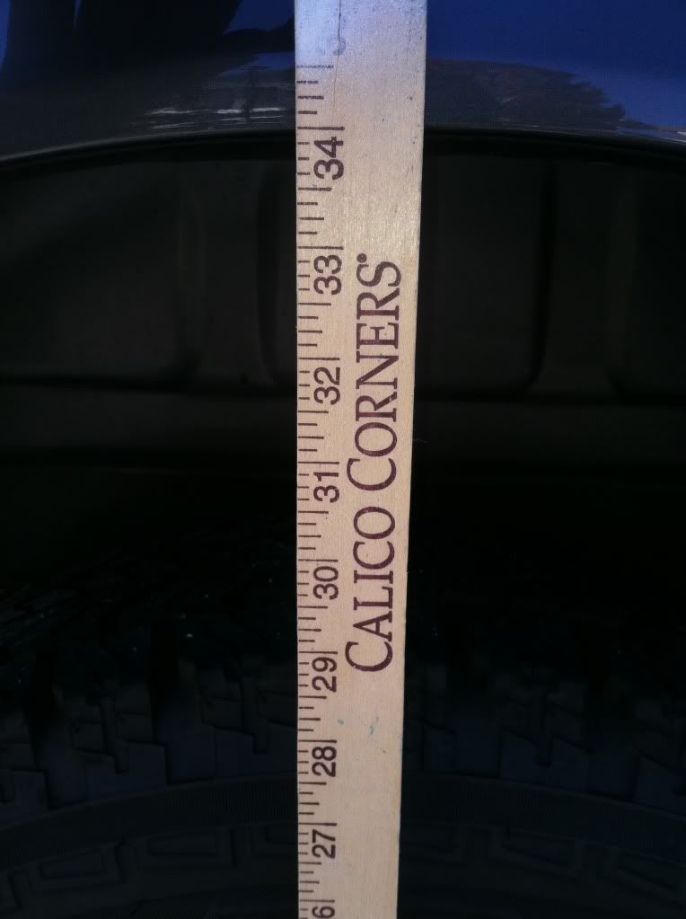

I adjusted the driver's side torsion bar one turn (approximately 1/4") to even out front ride height. I don't ever drive with any rear seats in the van and the fuel tank is next to empty right now. The rear driver's side started out 1/4" higher than passenger side, so drive it some and see if it settles and make adjustments from there.
Front measurement:
Rear measurement:

Postby Corsemoto [OP] » December 16th 2011, 12:40am
So...
I installed add-a-leafs to my spring packs, I picked up the Fabtech FTS202's that Shad0wXCalibur didn't have any use for since he went with S10 heavy-duty leaf spring packs. I noticed recently how sagged out my leafs were even unloaded and really bad even with moderate loads so decided to try the add-a-leafs as they were the cheap solution to my sagging leaf springs. I'll get into the install when I have time, I figured you'd rather see pictures in order to get an idea of what they do.
Previous to FTS202 leaf spring install with OLV 2" lift, shackles in highest position these are the measurements (ground to fender):
LF 33"
RF 33 1/4"
LR 34 1/8"
RR 34"
With FTS202 leaf springs installed:
LF 33 1/4" (+2 turns preload - I noticed this side was sagging again, same as pre-lift)
RF 33 1/2"
LR 35 5/8"
RR 35 5/8"
I then added lift to front in order to even out with rear via torsion preload and kept track of how many full rotations (if need to return to previous setting):
LF 34" (+4 turns, approximately 2 turns remaining before bolt bottoms)
RF 34" (+2 1/2 turns, only 1/2 turn remaining before bolt bottoms)
LR 35 5/8"
RR 35 5/8"
So the add-a-leafs added approximately 1 1/2" of lift in the back, the front is max lift with stock torsion keys and the vibration that appeared after the original 2" lift install has disappeared. :auto-mysterymachine:
Still sorting out some things with shocks and shock mounts but looks like going to be welding new shocks mounts on rear axle.
Here's an animation showing the the evolution of lift:
