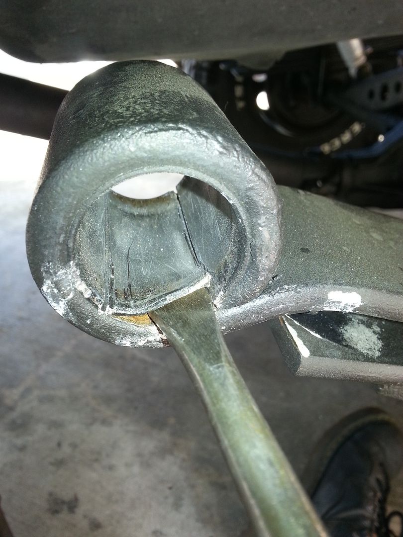

To upgrade you need to remove the old bushings. I did this in a three step process. First I used a two jaw puller from my front end service kit. I put the jaws on the leaf eyelet and pushed out the inner steel sleeve...the one the bolt fits through. Second I used a flathead screwdriver to pry out the rubber bushing. Once those are out of the way you have a steel outer sleeve to contend with. This is the PITA part.
I tried for an hour to cut the sleeve with an air hammer. Forget that. The sleeve is thin and its hard to only cut it and not mess up the spring. I wasted an hour trying. Then I got smart and decided to make some cuts down the sleeve and pry out a section. This is best done with a hacksaw for precision, but can be very carefully done with a sawzall too.
The cuts:
I then jammed a chisel in there and started pounding until that section ripped out:
After a minute with the sledge those sleeves will happily pop right out:
