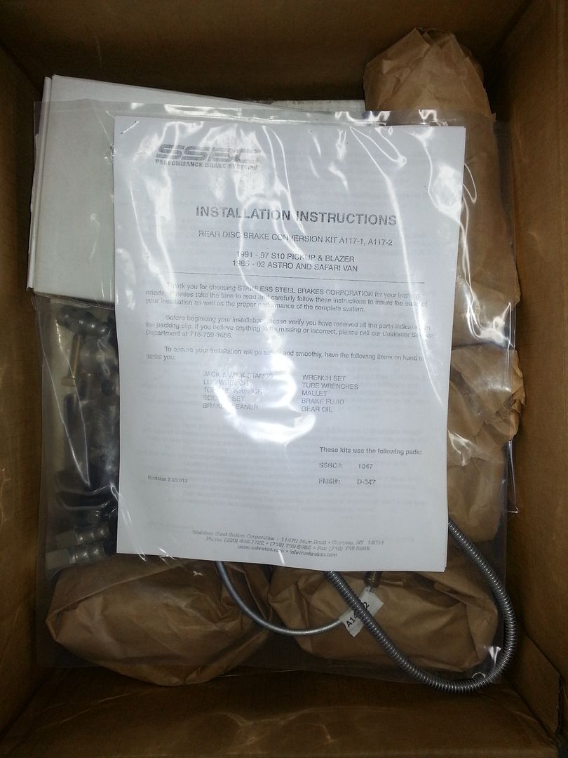

Here's the Kit:
My first thought was the shoes look very tiny and the discs are not very thick! Hmmmm. I hope this system is up to the task of stopping my 35" tires :think:
