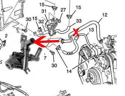

My van (2001 Safari 2WD passenger) has developed a leak in the hose going from the top of the intake to the heater control valve.
(It was installed by the local firestone when they replaced my intake gasket not too long ago and they cut it so short it is rubbing on the alternator pulley which has worn a gash in hose.) See red x in this diagram:
Would this be a good place to install a shutoff valve like Lumpy's to shut off hot water from the cabin for summer?
viewtopic.php?f=34&t=17221&p=181330&hilit=drippy#p181330
TIA
Charles
#2 ·
Sure it would work there.
But if you are going to install one my advice is to remove the valve and enjoy the extra heat provided when it is gone.
Otherwise a piece of pipe spliced in there would restore the hose length. If you got it laying around it a freeby fix.
So any of the above will work.

#7 ·
Now I'm confused. When you say "But if you are going to install one my advice is to remove the valve and enjoy the extra heat provided when it is gone" are you talking about the factory valve or the one I am considering installing where the hose is cut?
If the factory one, I have other hoses hooked up there as well-rear heat I guess.
#8 ·
Yes remove the factory one. Just join the hoses. Which will be another story since you have rear heat. Just join them where the factory valve was.Should be able to tell which goes where by looking at the factory valve. If not I can get er done. And install the lumpsters Acme water valve for control.
#10 ·
I went to hardware store and couldn't find a ball valve that would work-found a fairly compact brass one that had barbed nipples, but even though it was labeled 3/4" the nipples were closer to 1/2"-clerk said the 3/4" referred to the opening size of the actual ball in the valve. So I was going to put a straight cpvc barbed coupler in there to mend the cut the alternator made, and realized that would rub the pulley as well. So I now see why parts diagrams show a shaped hose there instead of straight heater hose. Make it any longer and it crimps. So I put a 90 degree elbow in and it seems to fit midway between alt pulley and fan blade pretty well. So I guess Firestone was trying to save me some $$ by using straight hose. Could have left me stranded on side of the road though. Lesson learned!! formed hoses are formed for a reason.
Will go to harbor freight to look for valve chevymaher described and put it up by firewall.
Kinda glad hardware store didn't have what I was looking for. It wouldn't have worked in that spot and it gave me time to think this through.
